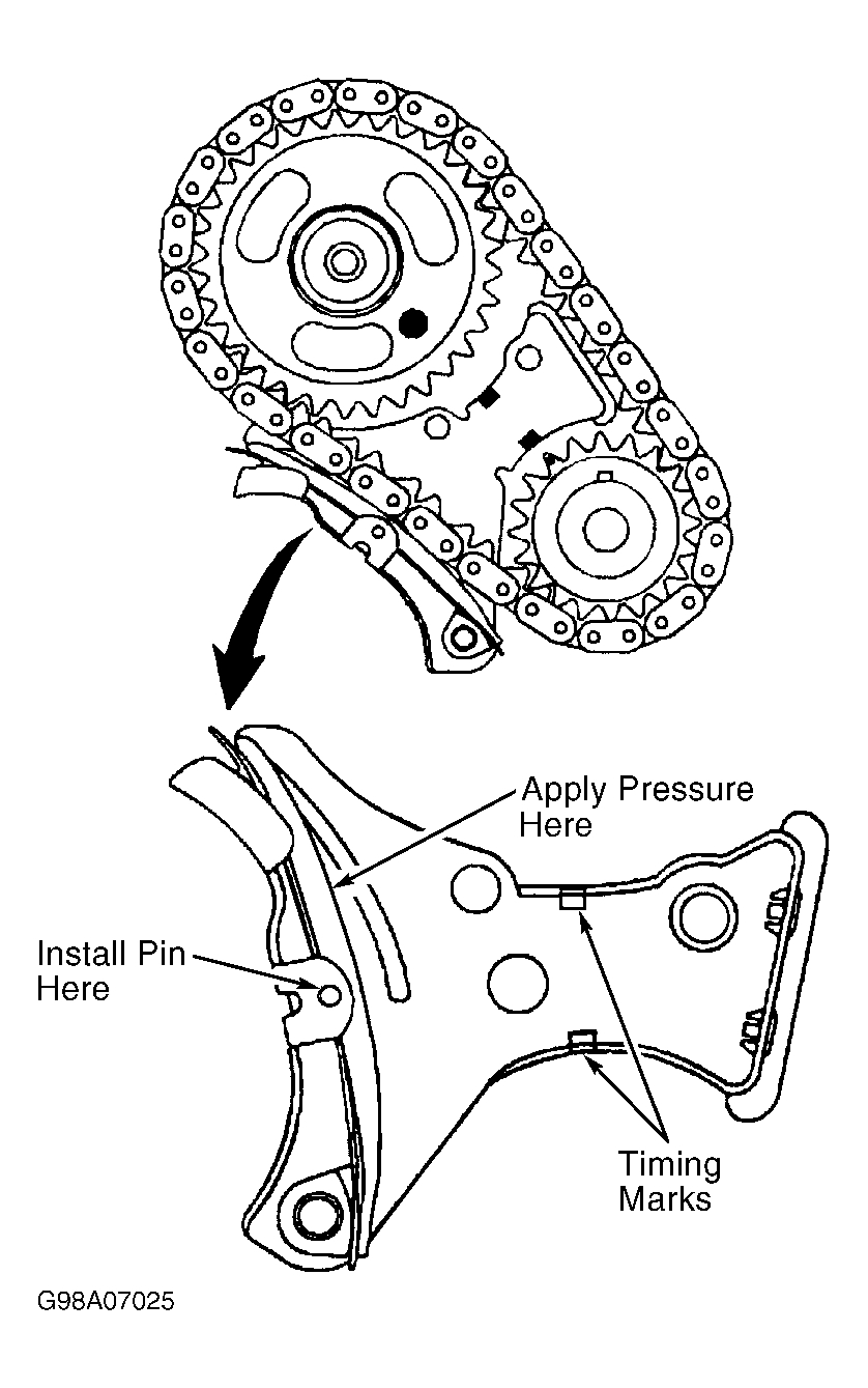

Can anyone help with the alignment for the timing chain, mechanic can not find them. He sees in on small gear but not the large one. I cant afford to start over and go to another mechanic. Thanks
Sunday, June 12th, 2016 AT 12:19 PM
SATURNTECH9
  • 30,869 POSTS
So how did he time the engine when he changed the chain.
+1
Sunday, June 12th, 2016 AT 6:01 PM
SATURNTECH9
  • 30,869 POSTS
Here you go.
+1
Sunday, June 12th, 2016 AT 8:24 PM
LETICIARAMOS2890
  • 56 POSTS
Thank you, will have him do it today.
Monday, June 13th, 2016 AT 6:47 AM
LETICIARAMOS2890
  • 56 POSTS
Finally got my car running, now need to get my muffler replaced. Thank guys for all your help.

Your welcome so the timing when he put it all together was just off?
Sunday, July 3rd, 2016 AT 2:48 PM
LETICIARAMOS2890
  • 56 POSTS
Yes and power steering pump had to be replaced. Driving with temporary fix on muffler til I can save money for new one.
