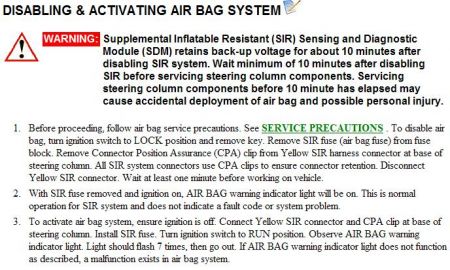

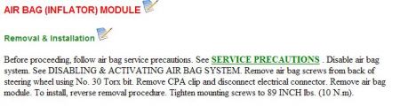

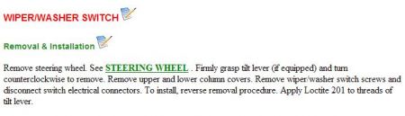

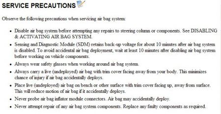

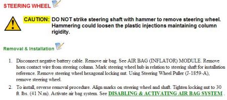

I need to replace the windshield wiper control on my Cavalier. I know I need to get past the air bag in the steering column. Is there a procedure I need to be aware of to access the wiper control and remove / replace the air bag? Is thee a danger of air bag discharging?

Follow replacement steps below and ensure you read the precautions carefully.
