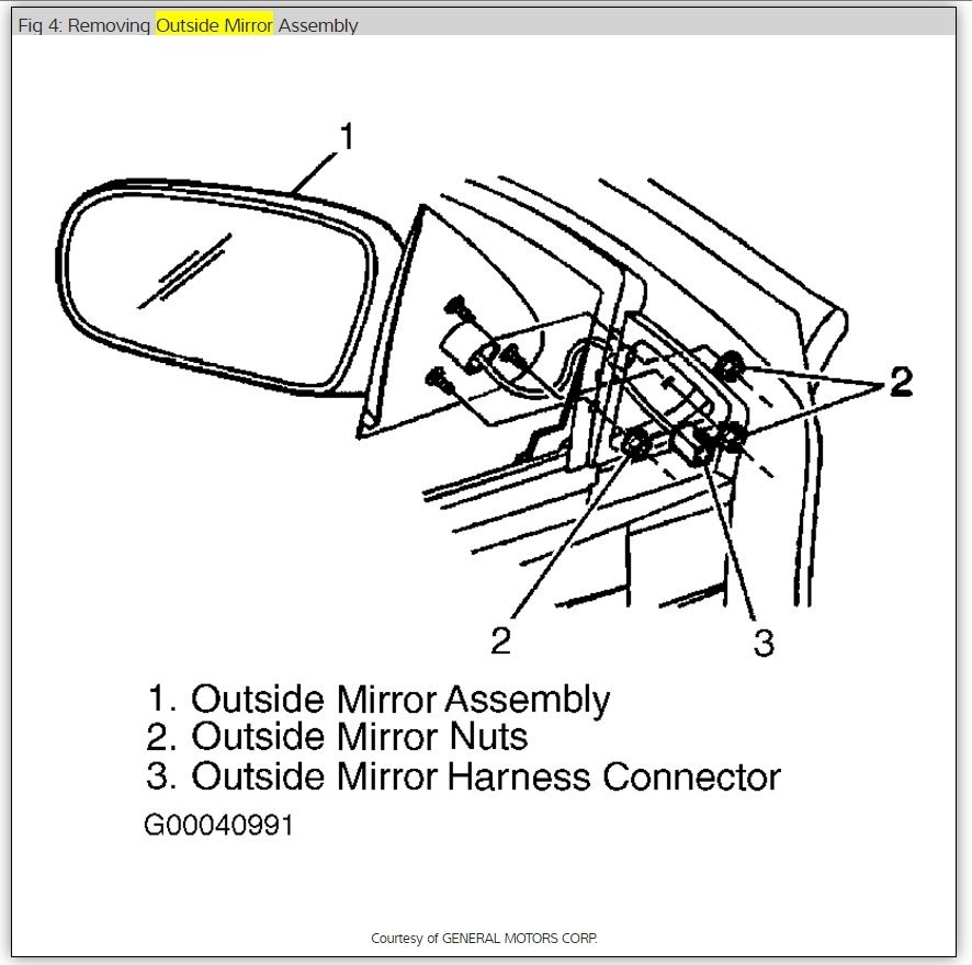

There is three main mounting bolts that must be undone to get the rest of the mirror off, then you will need a replacement because the plastic mount is broken.

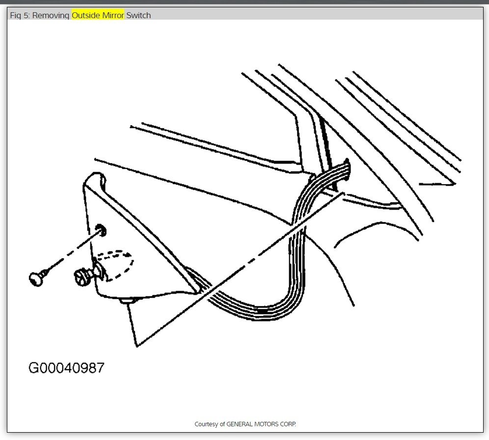

Here are some diagrams (BELOW) that will show you how to get the problem fixed.
