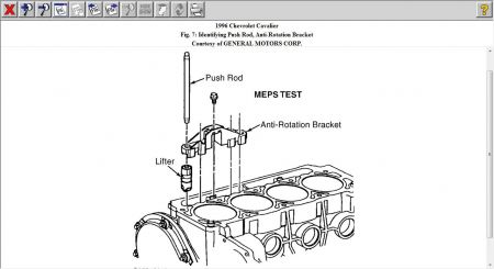

Hi RickSRQ, Welcome to 2carpros and TY for the donation The valve lifters are non adjustable-try doing this open it up and use a torque wrench and tighten down the rocker arm nuts to 22ft lbs and the anti rotation bracket bolts to 97inch lbs and see what happens- You could have did some damages or loosen something within the valve train at that speed limit-investigate thoroughly
https://images.2carpros.com/forum/automotive_pictures/12900_arb_1.jpg
