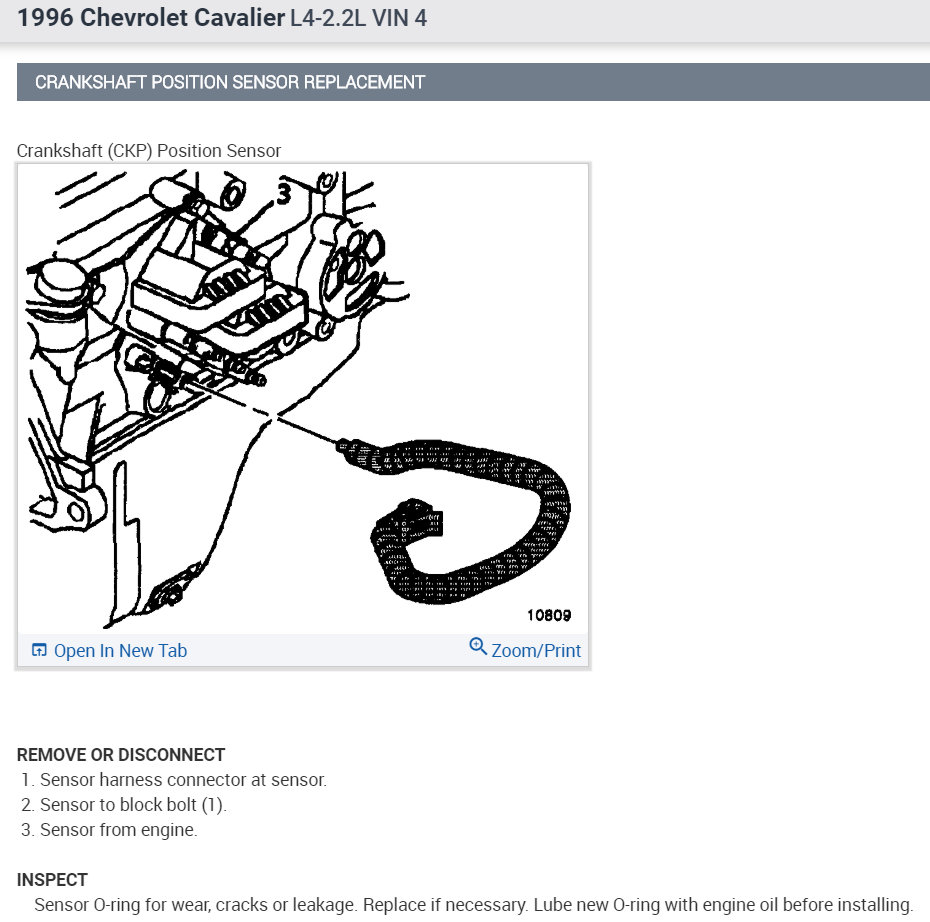

Crankshaft position sensor
1996 CHEVROLET CAVALIER
145,000 MILES • 4 CYL • FWD • AUTOMATIC
CHEF6777
Where is the crankshaft position sensor located and are there any special tools required to remove. I was told it's on the back side of the engine but I see 4 different sensors back there, would it be the one that is lowest by the crank & oil pan?
Nov 17, 2008 at 2:07 PM
  • 75,992 POSTS
Here is a guide to help walk you through the repair and diagrams below to show you the location and replacement below.
Nov 17, 2008 at 5:17 PM

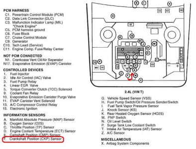

KIRKMOODY
Can you show me a diagram of where the Crankshaft position sensor is located on a 1996 Chevy Cavalier LS Convertible 2.4 liter? Also how to replace it myself.
Thank you,
Kirk Moody

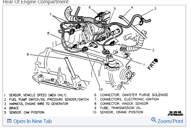

JIMMYMAY
Electrical problem
1995 Chevy Cavalier 4 cyl Front Wheel Drive Automatic
where is the crank position sensor located
Sep 24, 2019 at 12:32 PM (Merged)

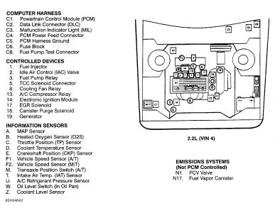

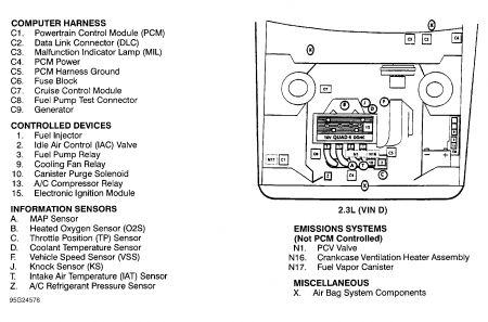

MHPAUTOS
  • 31,937 POSTS
Hi there. on the 2.3 litre....
https://images.2carpros.com/forum/automotive_pictures/61395_Noname_20.jpg
https://images.2carpros.com/forum/automotive_pictures/61395_Graphic_62.jpg
on the 2.2 litre....
https://images.2carpros.com/forum/automotive_pictures/61395_Noname1_12.jpg
https://images.2carpros.com/forum/automotive_pictures/61395_Graphic_1_9.jpg
Mark (mhpautos)

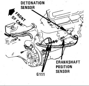

ROBERTWHIT
1989 Chevy Cavalier
where is the crank shaft sensor located on the 1989 cavalier
  • 75,992 POSTS
Rear Of Engine.
https://images.2carpros.com/forum/automotive_pictures/12900_c_23.jpg
Lower RH Side Of Engine Applicable to: V6-189/3.1L

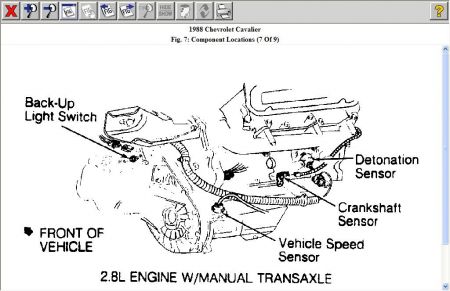

SUSAN05
1988 Chevy Cavalier
where is the crankshaft sensor located on a 1988 chevey cavalier
  • 75,992 POSTS
See below
https://images.2carpros.com/forum/automotive_pictures/12900_cps_16.jpg
