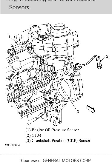

Where is it on my 2003 chevy cavalier?
Feb 28, 2016 at 12:35 AM
JDL
Experienced Mechanic
16,098 POSTS
Our info says it is down by the starter. You need to remove air-dam underneath, then remove starter.
Image (Click to enlarge)
Feb 28, 2016 at 3:03 AM
CHERYLDENI
MEMBER
2 POSTS
Thank you. That's exactly where it was.
