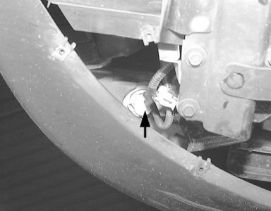

How do you change the turn signal bulb in the front bumper on a 1995 Chevy Cavalier?
Oct 27, 2008 at 9:52 AM
JNOVACK
  • 723 POSTS

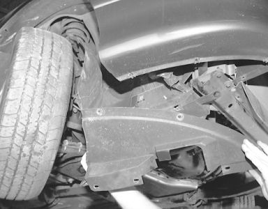

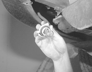

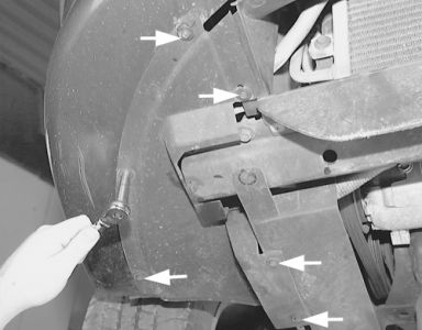

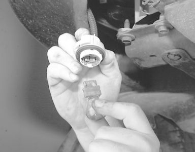

Remove the inner wheel well splash shield. Grasp the bulb socket and rotate it counter-clockwise to remove it from the lamp. Remove the bulb from the socket. Installation is the reverse of removal.
https://images.2carpros.com/forum/automotive_pictures/52960_0900c1528003cfad_1.jpg
Fig. 1: Remove the retaining bolts for the splash shield
https://images.2carpros.com/forum/automotive_pictures/52960_0900c1528003cfae_1.jpg
Fig. 2: ... remove the splash shield from the vehicle

Fig. 3: Twist the bulb socket to remove it from the lamp and ...

Fig. 5: Pull the bulb straight out to remove it from the socket
