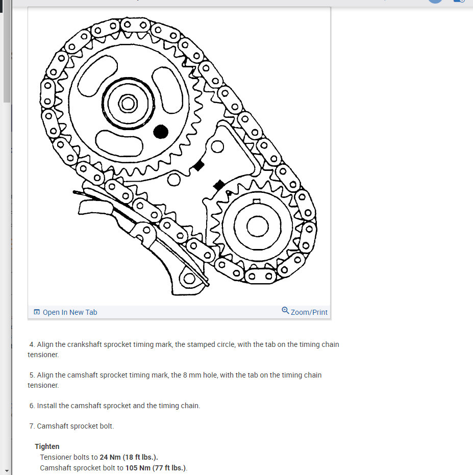

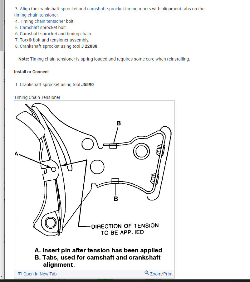

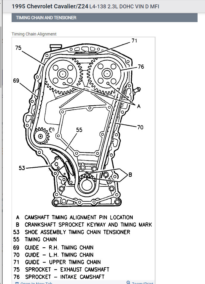

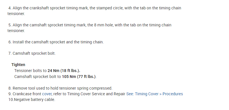

Needing to find out if my car has a timing belt or chain and where to find the timing marks, as well as knowing how to time it. Thank you for your time.
Saturday, February 28th, 2009 AT 8:43 PM

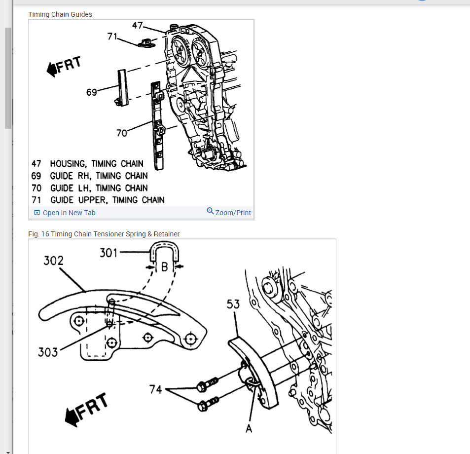

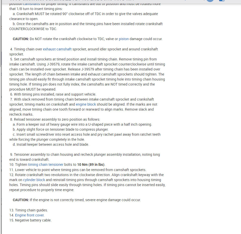

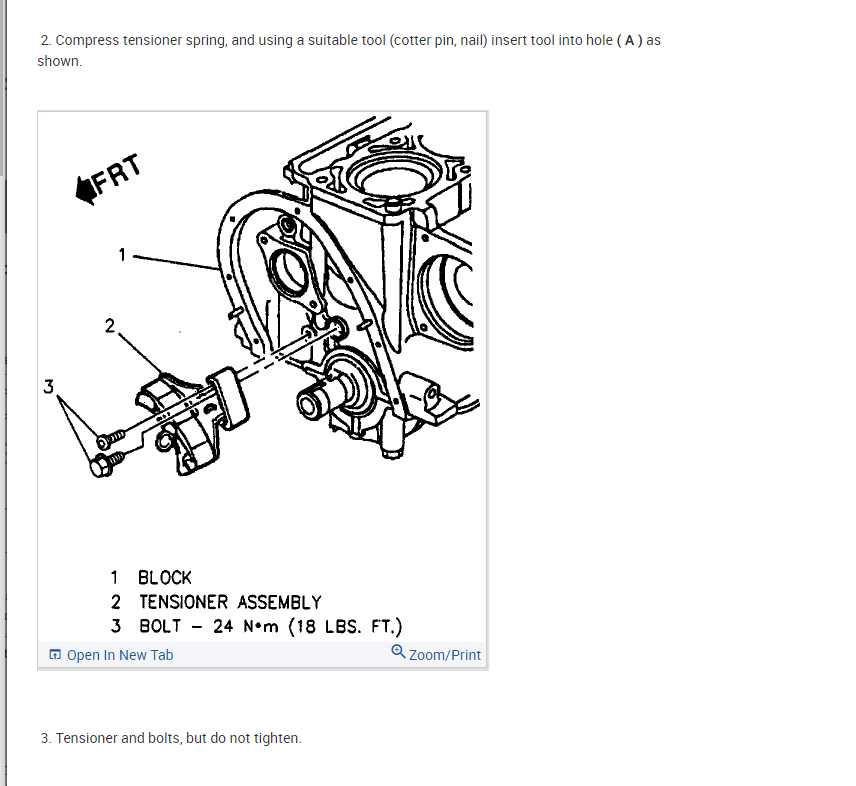

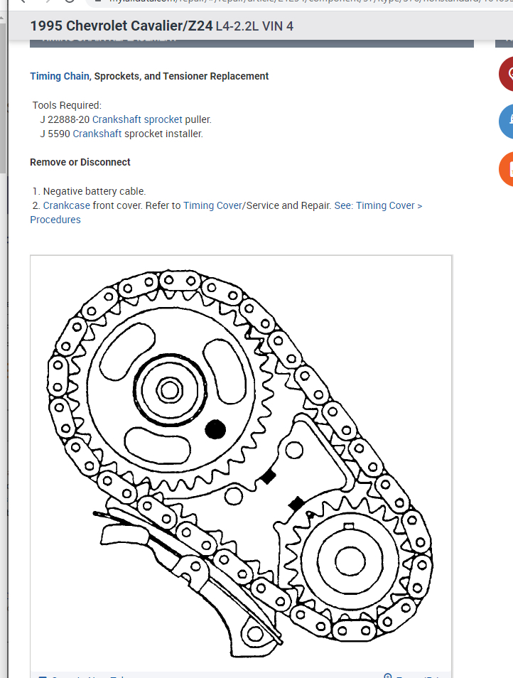

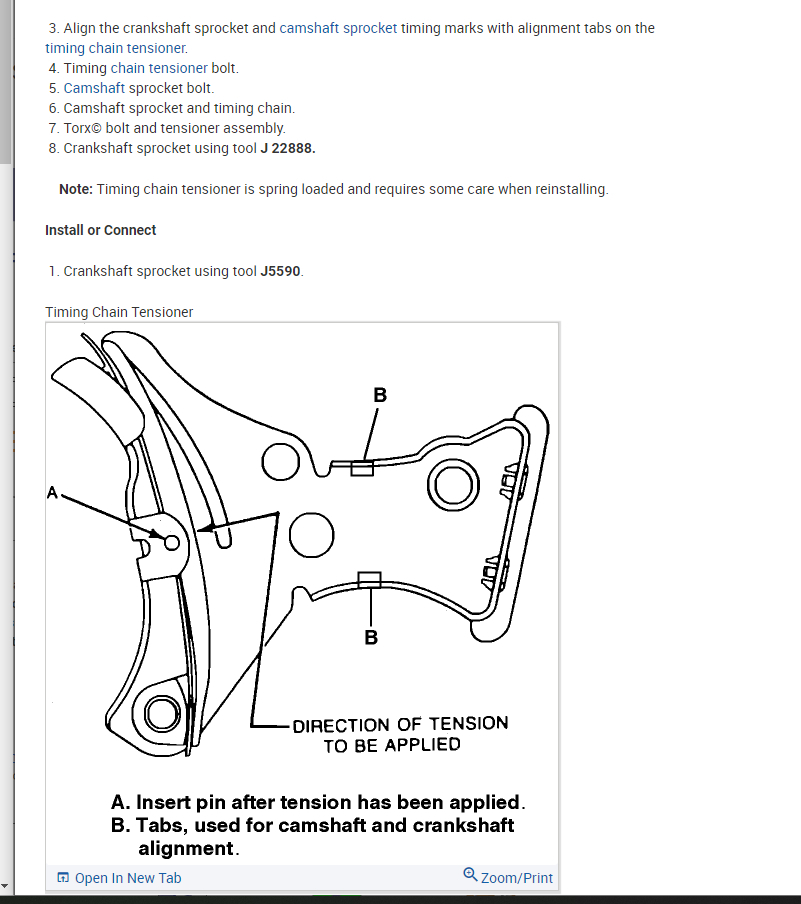

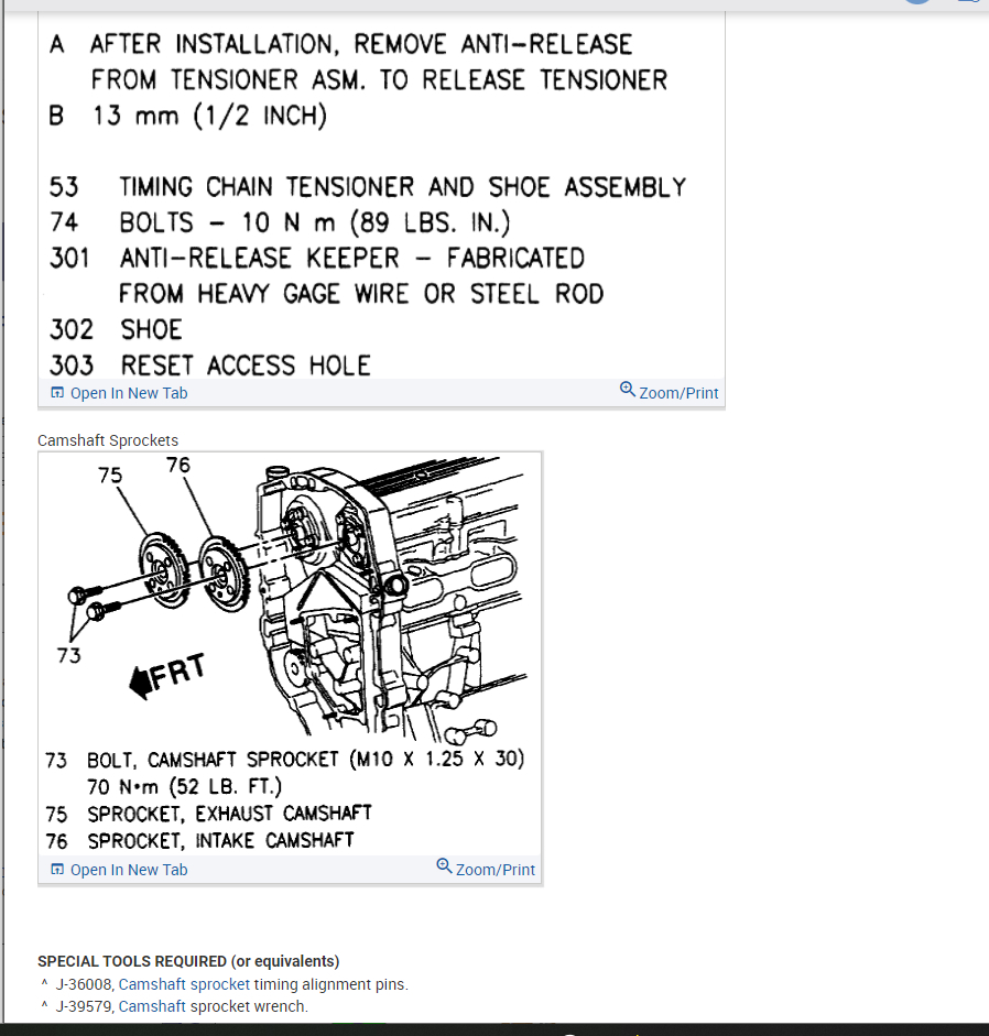

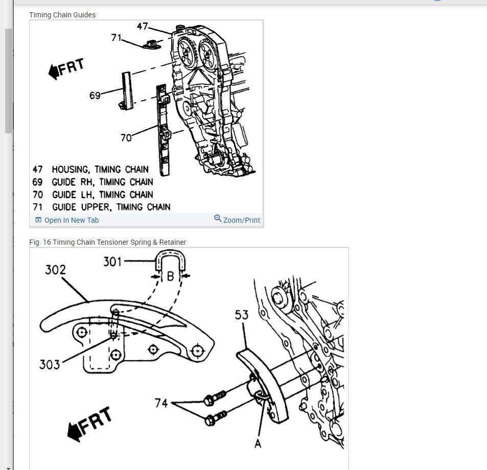

Both engine options have timing chains and they are not required to be replaced unless there is an issue requiring them to be replaced.
https://www.2carpros.com/articles/serpentine-belt-timing-belt-timing-chain-diagrams
I attached the info below that will help with replacing both since the engine was not mentioned.
Please run through this info and let us know if you have other questions.
Thanks
Monday, September 20th, 2021 AT 7:44 PM
