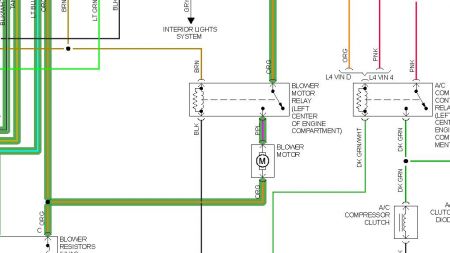

Took my blower motor off as their was a wire broken had to connect the wires with different connectors but there is still no blower their was 2 different wires orange and a purple is their another one some where used for ground. Can you help me

The blower motor relay grounds the circuit to the motor. Purple goes to the switch of the relay and orange goes to the blower resistor for speed control of motor. See below
