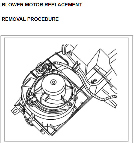

How do I install a blower motor on this car?
Nov 14, 2008 at 11:39 AM
BLUELIGHTNIN6
  • 16,542 POSTS

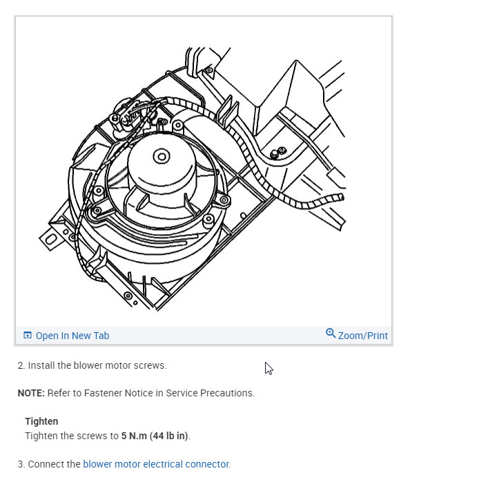

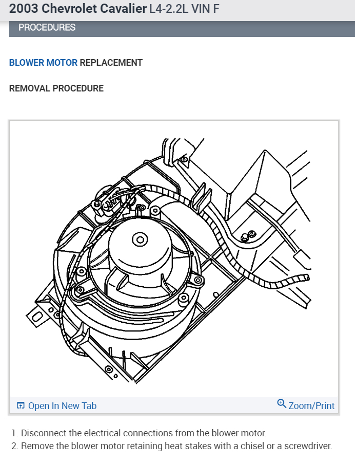

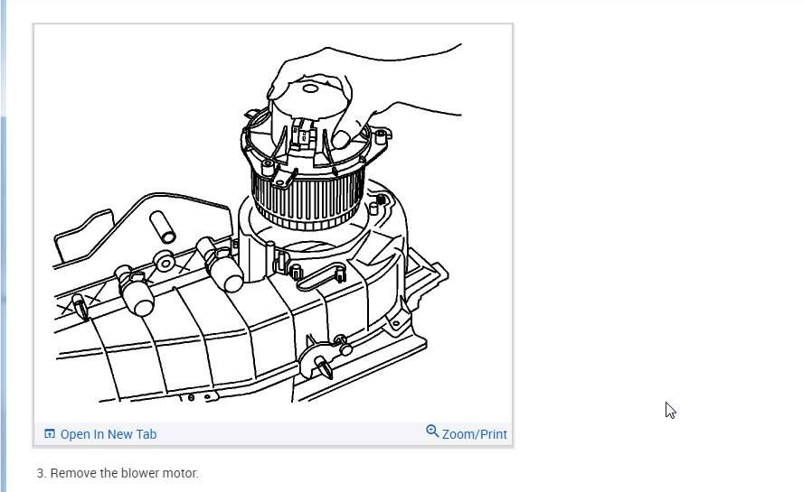

Removal: Disconnect the electrical connections from the blower motor. Remove the blower motor retaining heat stakes with a chisel or a screwdriver. Remove the blower motor .
https://images.2carpros.com/forum/automotive_pictures/261618_0900c1528005d5b6_2.jpg

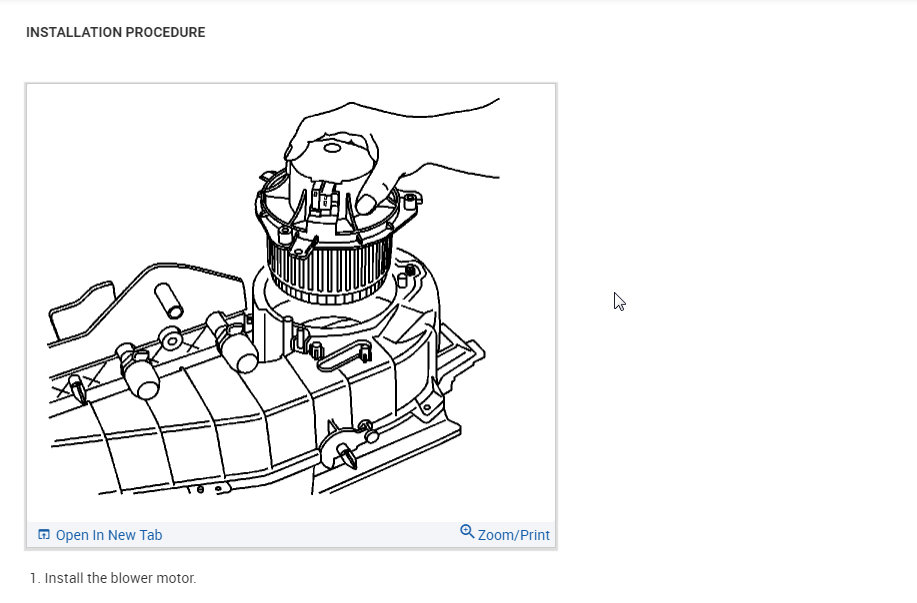

Note: Use the correct fastener in the correct location. Replacement fasteners must be the correct part number for that application. Fasteners requiring replacement or fasteners requiring the use of thread locking compound or sealant are identified in the service procedure. Do not use paints, lubricants, or corrosion inhibitors on fasteners or fastener joint surfaces unless specified. These coatings affect fastener torque and joint clamping force and may damage the fastener. Use the correct tightening sequence and specifications when installing fasteners in order to avoid damage to parts and systems. Installation: Install the blower motor screws and tighten the screws to 44 lb inches (5 Nm). Connect the blower motor electrical connector.

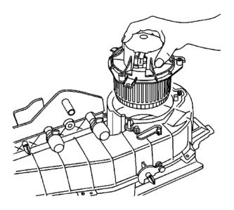

Hello, here is a guide to show you what you are in for when doing the job with diagrams below that show you how to remove blower motor on your car. Should be 7mm screws.

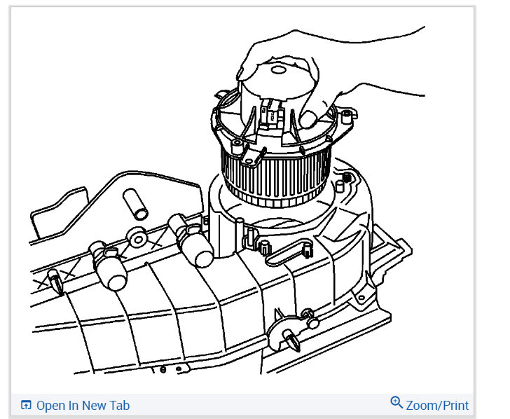

https://images.2carpros.com/forum/automotive_pictures/170934_cavalier_blower_motor_1.jpg
My parts book showed the above picture. The two holes around the edge are probably for the retainers, may be a third one on the opposite side of squirrel cage, that we cannot see in the picture? My information says to remove the retainers with a chisel or screwdriver. I do not have an actual picture of retainer, you need to be sure.

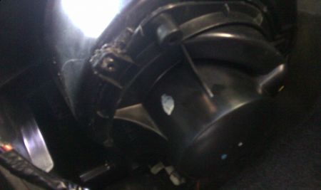

I am trying to remove my blower motor for replacement. It looks as though there is a housing with rivets keeping me from dropping the blower motor itself. I have attached a picture. I need to know next steps to either remove these rivets or am I missing something altogether.

those are heat stakes and you have to use a chisel to cut them out. purchase new fasteners for installing new blower motor. Here is a guide and diagrams below to show you how on your car.

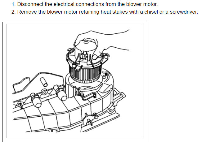

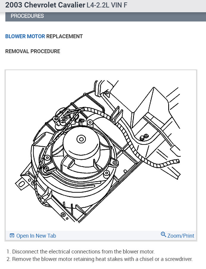

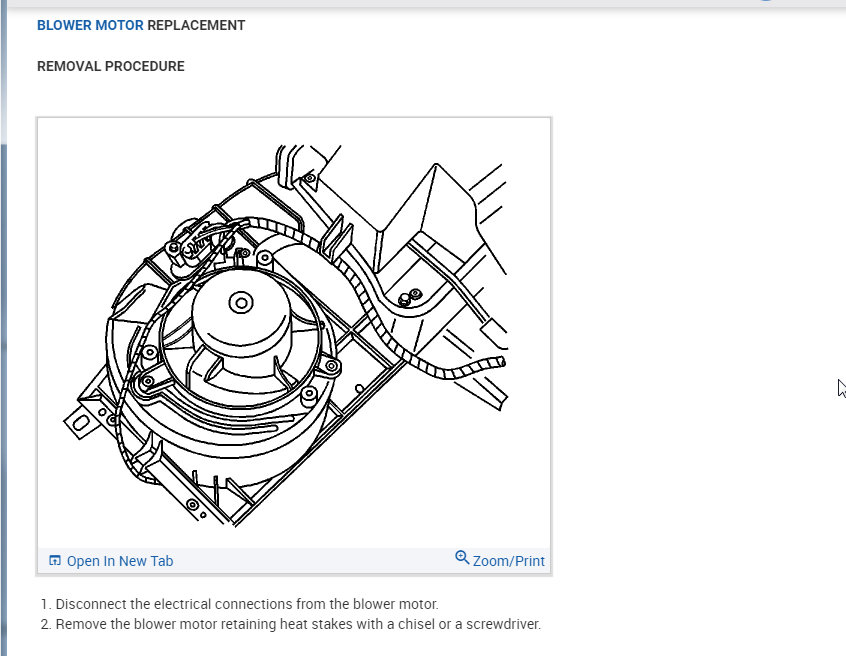

ROBERT KUKIC
2004 Chevy Cavalier
how to remove & install heater motor when there are no bolts holding original motor
Aug 25, 2020 at 10:17 AM (Merged)
BIGJIM79
  • 239 POSTS
[quote:ab30ab46cb="Robert Kukic"]2004 Chevy Cavalier
how to remove & install heater motor when there are no bolts holding original motor[/quote:ab30ab46cb]
There should be a plastic cover that hides the three bolts that hold it in place.
Thanks for that info.
I am attaching the info from the manual in the event someone else needs this detail. Let us know if you need other info. Thanks
