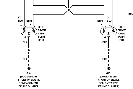

It definitely is an electrical problem and the right turn signal is affecting the ABS system.
Both the system shares a common grounding point and I believe this could be the cause.
The grounding point is G101, at lower right front of engine compartment, behind bumper. Check if the grounding point is loose, contaminated or corroded.

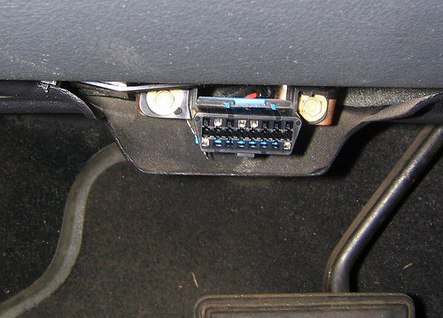

The DLC shown seems to be OBD-II but scanners comes in different standards so it is not surprising if Autozone does not have the correct one.
If you get any scanner, it should be equivalent to J-39200 standard.

Passenger side or driver side? Do you have an illustration of this?
"1995 ELECTRICAL COMPONENT LOCATION General Motors Corp. - Electrical Component Location" says that G101 is "At left front of engine compartment."
The diagram says right side though.
https://www.2carpros.com/forum/automotive_pictures/269800_Schematic_1.gif

Our database indicates it is on the right side.
The diagram is similar to the one you posted.

Hmmm. The upper turn signal bulb was out, which I hadn't noticed, but after replacing it I still have the problem. If I remove both upper and lower right turn signal/park bulbs, it still happens. I don't understand why. It doesn't happen for the left side even if I remove the left side bulb.
I don't see a ground point on the passenger side of the car, just a bundle of wires traveling across from behind the bumper, which splits into a bunch of stuff like turn signals, headlights, and horn.
I measure 16 ohms or less from the turn signal bulb terminals to the alternator body.

16 ohms is rather high resistance indicating the grounding is insufficient. Use a jumper to provide alternative ground for teh circuit to test if it affects anything.
