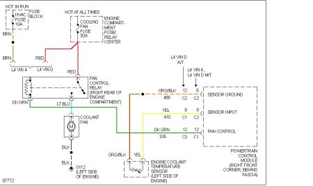

Okay, so I've had an overheating problem for some time now. I started by replacing the thermostat, which didn't help. So then I noticed the cooling fan wasn't turning on ever. I took out and the fan and tested it and the fan motor works. I replaced the ECT, the relay and the fuses on the fuse box. I replaced the PCM fuse also. I think it might be the wiring, but I'm just not sure. Have I missed anything?

Any applicable trouble codes? Does the fan run with ac turned on? I've seen fans with intermittent issues, faulty brushes. Seemed like every time I tried to test, it would run up a storm. Test the circuits at the fan relay. Voltage to the load side of relay is hot all the time. Voltage to the control/coil side of relay, depending on the vin, is either hot all the time or goes hot when you turn the key on. Ground for the coil side of relay, bottom left relay, is controlled by the pcm.
https://images.2carpros.com/forum/automotive_pictures/512072_cavalier_fan_relay_1.jpg
