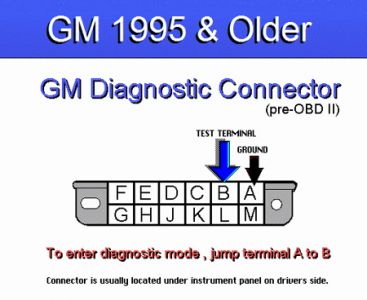

https://images.2carpros.com/forum/automotive_pictures/62217_95_OlderGM_13.jpg
Cross these two terminals as shown, then turn the key on. Count the flashes, a 22 will flash as 2 flashes then a short pause, then 2 flashes, if more than one code is stored, the pause will be longer. The codes will display three times and end with 12. Write them down and post here. You may have a vacuum leak or the throttle actuator needs to be serviced here are two guides to help us fix the problem. https://www.2carpros.com/articles/stall-at-idle and https://www.2carpros.com/articles/throttle-actuator-service and https://www.2carpros.com/articles/idle-air-control-valve-service Please run down these guides and report back.
