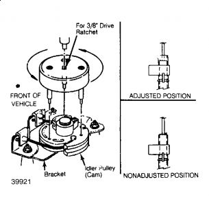

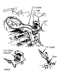

Check your TV (Throttle Valve) cable, it may be broke/binding/out of adjustment.
Depending on engine they look like this:
https://www.2carpros.com/forum/automotive_pictures/108325_Tv_cavilier_1.jpg
Or this:
https://www.2carpros.com/forum/automotive_pictures/108325_Tv_cavilier_2_1.jpg
