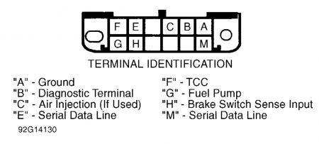

If the canister has fuel in it too it needs to be replaced, next read the codes.
Cross these two terminals as shown, then turn the key on. Count the flashes, a 22 will flash as 2 flashes then a short pause, then 2 flashes, if more than one code is stored, the pause will be longer. The codes will display three times and end with 12. Write them down and post here. This connector is right under the middle of the dash...
RETRIEVING CODES (WITHOUT SCAN TOOL)
NOTE: The Assembly Line Data Link (ALDL) may also be referred to as the Data
Link Connector (DLC).
With key on and engine off, locate Assembly Line Data Link (ALDL) connector under dash, on
driver's side of vehicle. Connect a jumper wire between ALDL terminal "B" (test terminal) and
terminal "A" (ground terminal). See Fig. 2. This places control module in diagnostic mode.
1.
NOTE: Connecting terminals "A" and "B" of ALDL connector with engine
running will cause fuel injected vehicles to enter field service
mode. The MIL (SERVICE ENGINE SOON) light will not flash codes
if this is done.
Fig. 2:
In this mode, control module will display DTC 12 by flashing MIL (SERVICE ENGINE SOON)
light. DTC 12 is identified by MIL (SERVICE ENGINE SOON) light flashing once, followed
by a short pause, then 2 flashes in quick succession.
2.
Each DTC will be repeated 3 times. DTC 21 is identified by 2 flashes, a short pause followed by
one flash; DTC 53 is identified by 5 flashes, a short pause followed by 3 flashes. DTC's are
separated by slightly longer pauses.
3.
DTC's are displayed in numerical order. Each code is displayed 3 times. DTC's will continue to
repeat as long as ALDL test terminal is grounded. If DTC's are not flashed, or MIL (SERVICE
ENGINE SOON) light does not glow, self-diagnostics will not work. See CHART A-1 under
DIAGNOSTIC CHARTS.
5.
NOTE: DTC's will be recorded at various operating times. Some codes require
operation of sensor or switch for 5 seconds; others may require
operation for 5 minutes or longer at normal operating temperature, road
speed and load. Therefore, some codes may not set in a service bay
operational mode, but may require road testing vehicle in order to
duplicate condition under which code will set.
https://www.2carpros.com/forum/automotive_pictures/62217_GM_OBDI_2.jpg

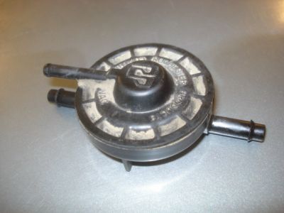

By way of review...on the charcoal canister exist 3-ports:
1-to atmosphere
1-to attachment at purge vale &
1-to a return line (cannot see where it goes) but must go to tank.
Merlin said (paraphrasing) if canister has fuel in it: REPLACE
No fuel is present in canister; however...
in the line from the canister to the purge valve I cleared (gently blew-out fuel liquid); and when gentle air was applied to what I'll call 'to the tank line' you could here/see slight evidence of fuel too? I did not attempt to apply more air flow not knowing where this line was connected at the fuel tank? IS THERE some device that could be damaged (like a one-way valve or another vacuum device???) when air would be used to 'clean out' any liquid fuel?
REF purge valve...I put the vacuum to the port...while removed from the engine...
it appears to function properly (with vacuum applied one can move air through the valve & with-out vacuum there is no flow through). GOOD PURGE VALVE?
PURGE VALVE TO ENGINE CONNECTIONS:
vacuum port at engine is sucking BUT
the larger port shows no evidence of suction: is this correct? IF not why?
COMPUTER CODE REF in your response...
no codes stored: only the 12 code.
what do you say?
https://www.2carpros.com/forum/automotive_pictures/563219_CANISTER_PURGE_VALVE_002_1.jpg
Friday, August 20th, 2010 AT 10:07 AM

I'm sure not wanting to drop the tank.
Is there ab image of the line from tank to canister:
can I put air into this line at the canister end. Back flushing into tank?
This is a 1993: no electrical connections on canister or purge valve,
you still haven't said anything about whether the the rubber hose connection from the purge valve to the engine (one goes to vacuum [smaller one]) and connects to a port. Likely to facilitate vapor back into motor. Should there be a presence of suction here?
Thanks

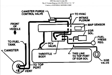

You posted alot of stuff; BUT
I din't ask about PVC system; and
I didn't ask about 2.3 L stuff; and I surely
don't have any 12v activated purge valve.
REF Fuel Tank Pressure Control Valve:
Does the 1993 Chevy Cavalier 2.2L have one; and if so
is it a vacuum or electric type?
Roman
Sunday, August 22nd, 2010 AT 6:57 PM
MERLIN2021
  • 17,250 POSTS
It has one on top, vacuum operated. 2.2 has no purge solenoid, sorry for the confusion..
https://www.2carpros.com/forum/automotive_pictures/62217_Vac_Diagram_1.jpg
