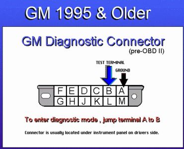

Cross these two terminals as shown, then turn the key on. Count the flashes, a 22 will flash as 2 flashes then a short pause, then 2 flashes, if more than one code is stored, the pause will be longer. The codes will display three times and end with 12. Write them down and post here. This connector is right under the middle of the dash...
https://www.2carpros.com/forum/automotive_pictures/62217_GM_DLC95_Older_20.jpg
Post the codes here.

I dont know how to cross the terminals is there any way of telling whats wrong even if its just a guess of whats likely wrong?

If you can change plugs, you can run this test. But if it's been a while since your last tune up, Plugs filters and an oil change to start, without the codes, we are GUESSING.

All you need is a paper clip, plug it into the terminal as shown in the picture, turn the key on, and the SES light will flash the codes. It's real easy, a caveman could do it! TPS voltage may be off, if you need a guess instead!

OK I did it I crossed the two terminals it flashed once then a short pause then flashed twice then a long pause then just kept repeating this
