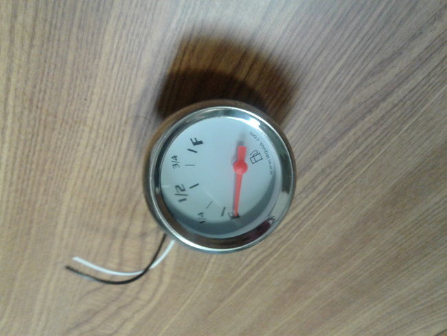

Hello, having issues with the gas gauge not working rather going through all the wiring. I just went out and bout a universal gas gauge to hook up near the dash. The fuel gauge I bought only has two wires to connect. Can you tell me how to hook this up to my car? Is there a wiring diagram to the fuel pump?
Friday, July 6th, 2018 AT 8:43 AM
IGENIUS92
  • 205 POSTS

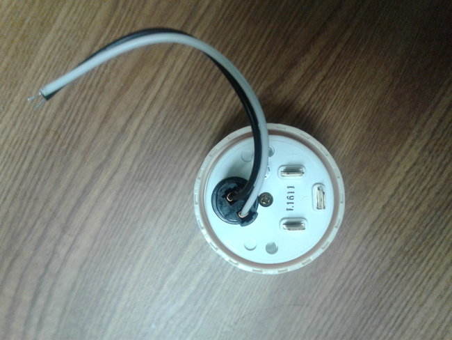

My apologies, I the fuel level gauge I bought has a connection for three wires the sender unit wire, ground, and 12 volts. I just need help wiring this to my car so that it works. I am not sure of the colors of the wires to the pump, but I believe it is three wires. I need to know which is which and the best way to hook this gauge up to my car so it works properly.
Friday, July 6th, 2018 AT 9:30 AM
IGENIUS92
  • 205 POSTS
Here is what the gauge looks like.
Friday, July 6th, 2018 AT 9:34 AM

For the cluster you need to test the black and black and white wire for ground. For the gauge which might work use the power ground and signal wire from the sender.
Friday, July 6th, 2018 AT 9:57 AM
IGENIUS92
  • 205 POSTS
Oh okay, the black and white wire on the actual gauge? Those two are the wires for the bulb it pulls right out to replace the bulb.
What wires should I hook the gauge to on the car?
Friday, July 6th, 2018 AT 10:05 AM
KEN L
  • MASTER CERTIFIED MECHANIC
  • 48,380 POSTS
The black and black and white was to check the cluster grounds. The wires must be connected to the spade terminals it should say on the back of the gauge which wire goes to what use the wiring diagrams to see which is the fuel sender wire.

Update: So I found the wires to make the gauge I bought work. Here is what I did: I located the purple which is the sender wire the grey which is the power and black which is the ground connected the wires exactly ran it through the car all wires tucked away nice and neat and the gauge it working great. Thank you for all your help it is much appreciated!
