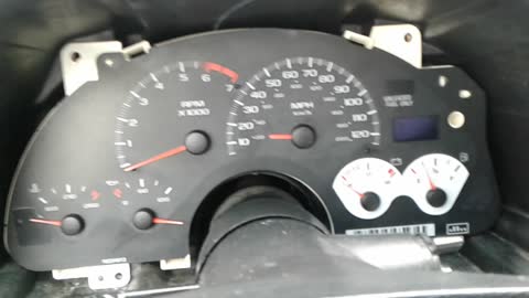

Okay, so update: About the gauges not reading correctly on my 1998 Chevrolet Camaro. I pulled the PCM/injector fuse and disconnected my battery for about an hour thinking it would help reset the cluster. I removed the needles and placed them in what I thought is the proper place. I had to get towed home last night because I drove the car quite awhile looking at the gauges mph and rpm seem to look okay, but I did not notice the gas gauge not moving and ran out of gas, bummer. Can you please please help me getting my gauges back on track and reading correctly? Is there anything that can be done?
Feb 28, 2018 at 3:35 AM
  • 55,782 POSTS
Bummer, can you take a picture or video and upload it to the site here so I can see whats going on? It sounds like you may have a bad ground for the cluster. Show me what the gauges do with the key on and then start the engine.
Thanks , Ken
Mar 1, 2018 at 2:33 AM
IGENIUS92
  • 205 POSTS
Sure, here is a video of it.
Mar 2, 2018 at 3:26 AM
  • 55,782 POSTS

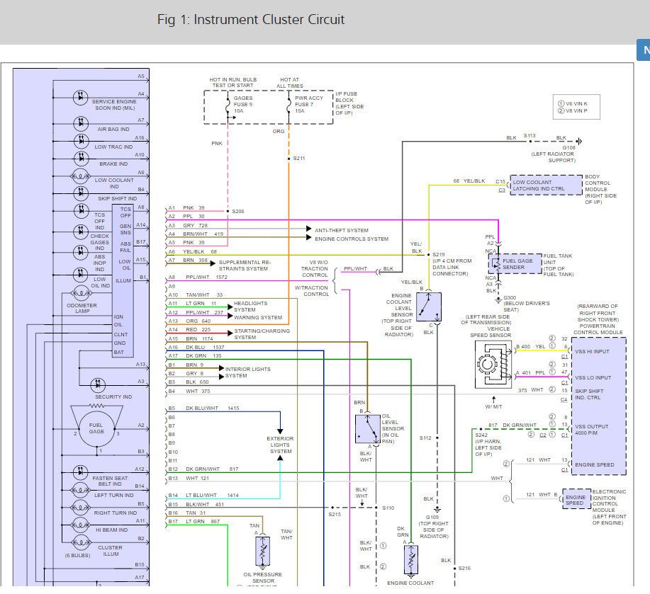

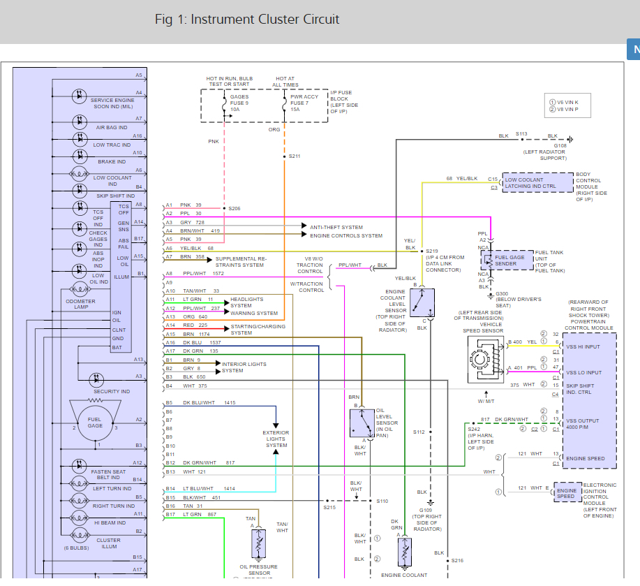

Great video! Really helps me see whats going on. I would unplug the cluster and test for proper ground and power. Here is a guide to show you how:
Here is the wiring diagrams so you can see which wires to test also check fuse # 9 and #7. Both pink and red should have power with the key on.
Check out the diagrams (below)

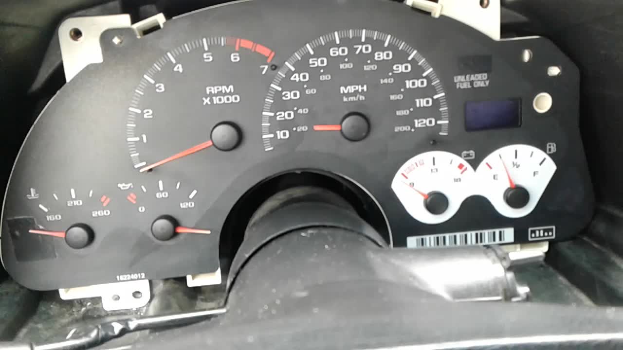

So update: I checked the wires and seem to be fine. I went to the junk yard and grabbed another cluster identical to my original one plugged it in, but I cannot tell if it is accurate. Geez I wished I never touched those needles I am having such a difficult time.
Mar 4, 2018 at 5:26 AM
  • 55,782 POSTS
Yes, the cluster can be delicate. What is the new cluster doing? Does it act normal?
Mar 5, 2018 at 2:49 AM
IGENIUS92
  • 205 POSTS
Well, it seems to be acting okay but when the car is off and no key in the ignition the gas gauge moves up to a little passed a quarter of a tank and when I turn the key in the start position the needle drops to empty, but there is gas in the vehicle. The battery gauge does not seem to be reading it is full voltage.
Mar 5, 2018 at 3:03 AM
  • 55,782 POSTS
Okay, if the rest of the gauges work okay there is a fuel level sender that has gone out in the tank which is part of the fuel pump module. Check the wire for continuity and if okay replace the sender. You will need to remove the tank to do so.

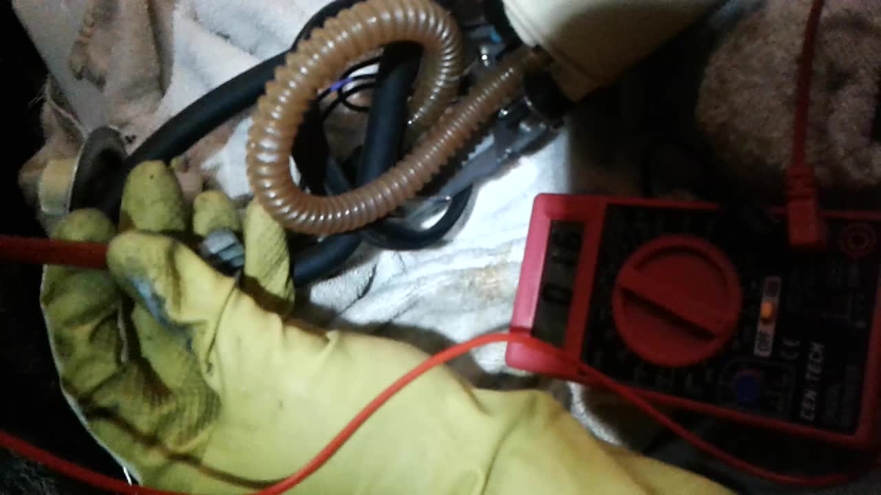

Hi Ken, I have a question how would I test the fuel sensor sending unit aka "float" on my car 3800 series engine? If I were to use the trap door in the trunk instead of dropping the tank and remove the fuel pump itself what measures should I go about testing the sensor "float" on the pump using a multi-meter tester? What wires should I connect to to get a proper reading? And where is the fuel pump relay should I check that too? What exactly does a fuel pump relay do?
Mar 9, 2018 at 1:25 AM
  • 55,782 POSTS
Oh yes, you can do that no problem. It is the purple wire use a volt meter to a metal part of the fuel pump module and move the float up and down then you can see the resistance change.

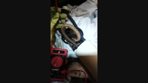

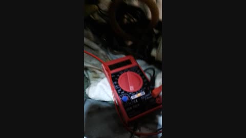

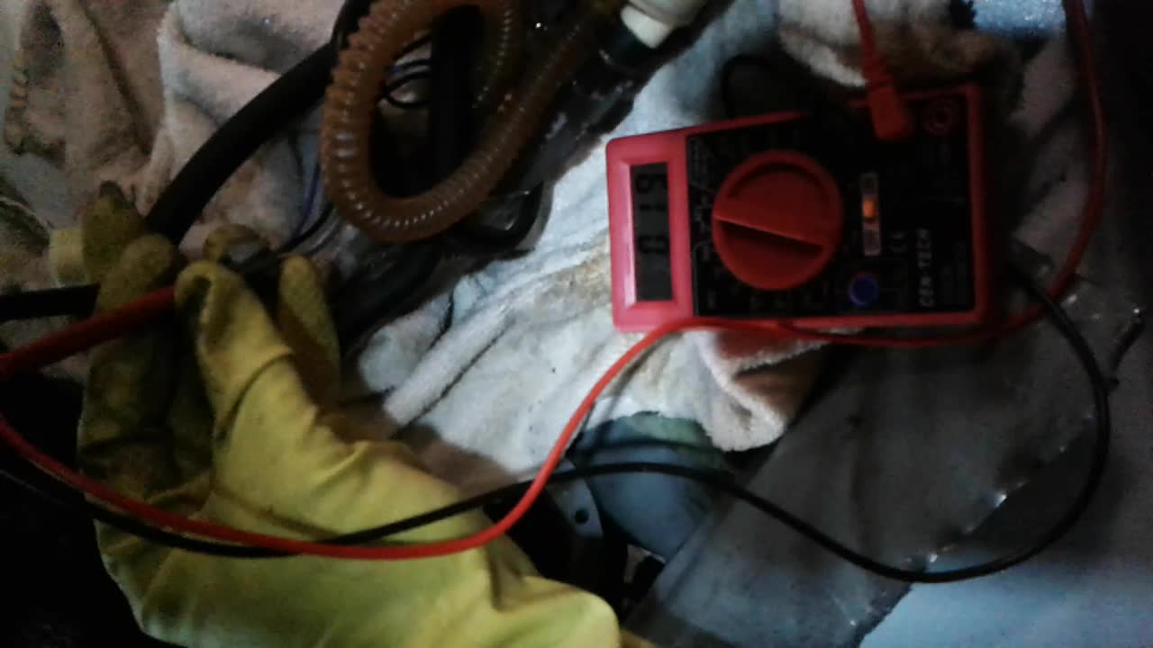

Hello, well here is an update: I so I finally got the fuel pump assembly out to test. Here is a video or two I think the float aka sensor is working properly, but I am not to sure. I would just really like to figure out my gas gauge issue not working please help!
Mar 18, 2018 at 3:59 PM
  • 55,782 POSTS
The float is working good so that is not the problem. You must be loosing signal in the wire or the gas gauge itself is bad. Go ahead and connect the sender and do the same test at the cluster, you should be able to see the same results at the cluster. (purple wire) nice work on the videos.

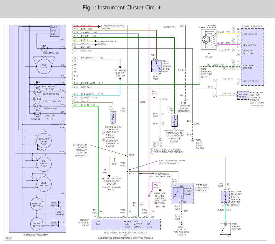

No problem. It is difficult to test the gauge without a signal generator, which is basically a sender. Let test the cluster power and grounds. Use the wiring diagrams on the previous post. Lets get this fixed!

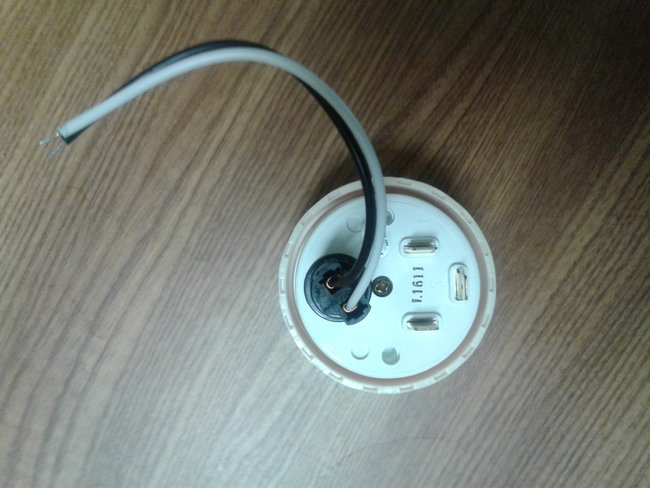

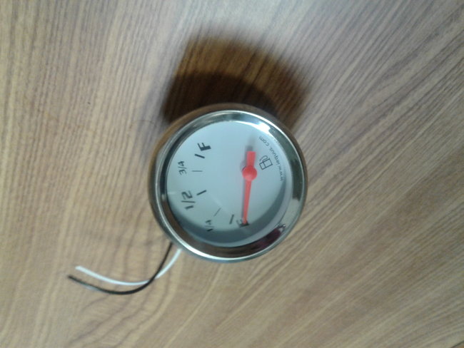

Hello, having issues with the gas gauge not working rather going through all the wiring. I just went out and bout a universal gas gauge to hook up near the dash. The fuel gauge I bought only has two wires to connect. Can you tell me how to hook this up to my car? Is there a wiring diagram to the fuel pump?
Jul 6, 2018 at 1:43 AM
IGENIUS92
  • 205 POSTS
My apologies, I the fuel level gauge I bought has a connection for three wires the sender unit wire,ground, and 12 volts. I just need help wiring this to my car so that it works. I am not sure of the colors of the wires to the pump, but I believe it is three wires. I need to know which is which and the best way to hook this gauge up to my car so it works properly.
Jul 6, 2018 at 2:30 AM
IGENIUS92
  • 205 POSTS
Here is what the gauge looks like.
Jul 6, 2018 at 2:34 AM
  • 55,782 POSTS
For the cluster you need to test the black and black and white wire for ground. For the gauge which might work use the power ground and signal wire from the sender.
Jul 6, 2018 at 2:57 AM
IGENIUS92
  • 205 POSTS
Oh okay, the black and white wire on the actual gauge? Those two are the wires for the bulb it pulls right out to replace the bulb.
What wires should I hook the gauge to on the car?
Jul 6, 2018 at 3:05 AM
  • 55,782 POSTS
The black and black and white was to check the cluster grounds. The wires must be connected to the spade terminals it should say on the back of the gauge which wire goes to what use the wiring diagrams to see which is the fuel sender wire.

Update: So I found the wires to make the gauge I bought work. Here is what I did: I located the purple which is the sender wire the grey which is the power and black which is the ground connected the wires exactly ran it through the car all wires tucked away nice and neat and the gauge it working great. Thank you for all your help it is much appreciated!
