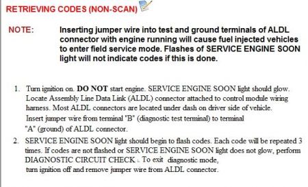

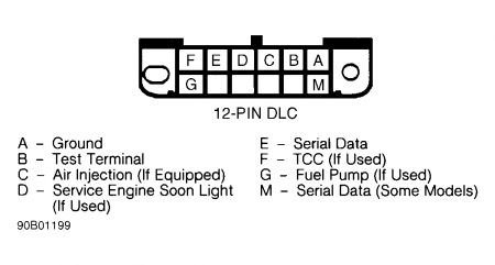

How do I check for DTCs without using a code reader?

If your car does not have the 12 pin DLC connector, you may not be able to manually "flash" your trouble codes. The language "may be possible" appears to suggest that this method should work with most, if not all, 12 pin DLC equipped cars.
THE CONNECTOR
| 1 2 3 4 5 6 |
| 7 8 9 10 11 12 |
DISPLAYING THE TROUBLE CODES
Run a wire/hairpin from Pin 5 to Pin 6 with the ignition off then turning the ignition to the on position without starting the engine will flash the "Service Engine Soon" light in the following sequence: flash, pause, flash-flash, long pause flash, pause, flash-flash, long pause flash, pause, flash-flash, long pause Following this "12" code repeating three times will come any trouble codes stored, flashing each of them three times. If you do not see the "12" flash three times, your diagnostic circuit is defective. Some vehicles will display stored trouble codes, then "12" again, followed by energizing "most system controlled relays." The fuel pump relay will not energize. The idle air control valve will fully extend to enable checking minimum idle speed.
CLEARING THE TROUBLE CODES
Turn the keyswitch to the off position. To clear any trouble codes, disconnect the power feed for 30 seconds. If this is done at the battery, and your car stereo is equipped and programmed with a four digit pin code, you may have to re-enter that as well to use your stereo again. A better place to remove power is at the fuse.
