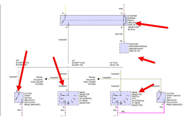

I have a the RS model that will not do anything when you turn the key to start it. New starter, good battery, new alternator, new neutral safety switch. It will not click or nothing. What could it be?

THE MOST IMPORTANT thing you can do, is go to Chevy dealer with the Vehicle Identification Number, it's on the dash behind the left side of the windshield, have them make a key with your V.I.N. This will ensure you have a key that should work, until then, we cant measure the resistance on the key, or start the car.

It goes through these things prior to going to starter, you may have one that has a security module that I did not mark as most did not check the relay. It may be in the inconvenient center on left hand side of steering column. See picture.

Do you have to remove the plug to test the resisters so it will start. There is a plug like there I tryed it and no luck with the plug there is two wires passed the plug there are purple and white is that the ones it a 91 camaro ty john.

If your key has a chip on it, then you have the security module. Take your key to the dealer and have it checked. They will probably do it for free or pretty cheap. Let us know.

Check your email for testing everything reated to the security system. Special interrogator tool needed to test for the correct resistance, or VIN taken to Chevy.
