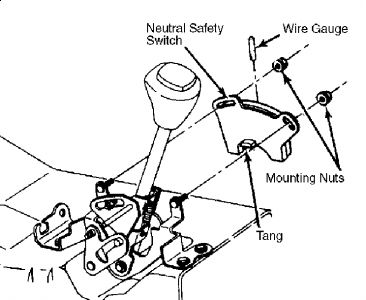

RED_WING45
  • 33 POSTS
  • 1991 CHEVROLET CAMARO
Electrical problem
1991 Chevy Camaro 6 cyl Two Wheel Drive Automatic
i have a 91 camaro, I put a starter in it wont start. The guy got a key cut, he said from a dealer. Whats wrong help. Ty john
Tuesday, April 7th, 2020 AT 11:59 AM (Merged)

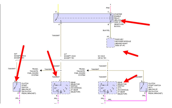

MERLIN2021
  • 17,250 POSTS
It may be the wrong key, or it may be the wire for keysense broke in the column, but it sounds like an ignition/key problem, Do all lights and radio work? Or is the car dead? And have you checked the cable going to the starter?
Some dont even have the chip. It can be the starer solenoid at the starter on GM. For an "engine not cranking" condition with A/T, determine if condition exists in both Park and Neutral positions. If condition occurs in one position and not other, a more probable cause is neutral start switch.
https://www.2carpros.com/forum/automotive_pictures/62217_NSS_1.jpg

Yes but you need to reassemble it without breaking the wire. But you should test for power at these other locations. If the VIN was given to the Dealer that made the key, they should have given him the right one. Neutral saftey, bad connections at starter, bad starter, or blown fuse can all do this to you! Checked all fuses? Even the ones under the hood? Checked for power at the wires on the starter when in crank?

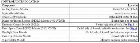

MERLIN2021
  • 17,250 POSTS
The original Key needs to be looked at for a resistor chip, then measured...Call Chevy dealer with your VIN and see if the can look it up "as built" Then you'll know for sure. Behind the right side of the dash is the passenger key decoder module. If it has one, then your car should have a chip on the key.
https://www.2carpros.com/forum/automotive_pictures/62217_cam_1.jpg
