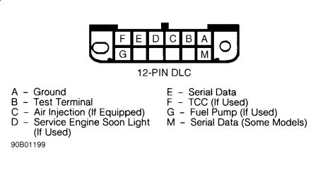

Need to check ECM for codes locate ALDL underdash see diagram
https://www.2carpros.com/forum/automotive_pictures/198357_Graphic_301.jpg
place jumper wire from A to B term. Key on no start MIL will flash so flash, flash, pause flash = 21.
Post codes will advise
