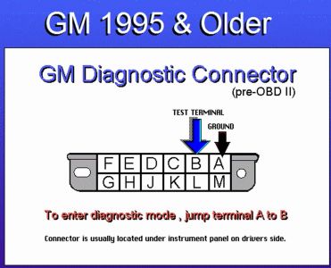

Sounds like a bad sensor maybe an 02 since it happens when the engine goes into open loop...check the codes...
https://www.2carpros.com/forum/automotive_pictures/62217_GM_DLC95_Older_10.jpg
Cross these two terminals as shown, then turn the key on. Count the flashes, a 22 will flash as 2 flashes then a short pause, then 2 flashes, if more than one code is stored, the pause will be longer. The codes will display three times and end with 12. Write them down and post here. This connector is right under the middle of the dash...

I keep getting the same flashes from the service light.
It flashes once and then twice. A short pause. Then flashes once and then twice and it keeps doing that until I turn off the key.
