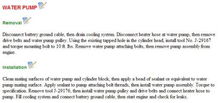

https://images.2carpros.com/forum/automotive_pictures/261618_Noname_700.jpg

what is tool number j-29167 and what is tool number j 29176

torque wrenches
