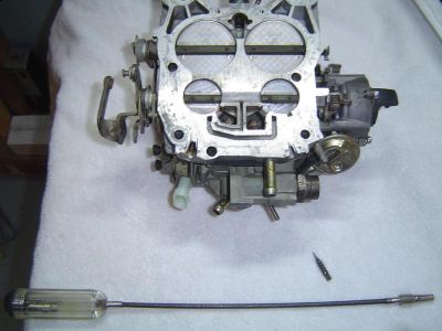

RACEFAN966
  • 5,029 POSTS
Ok with what you have told me if no engine light is on then I would rebuild the carb so I could remove the factory plugs so I could adjust it. What is more then likely happening is it is running either to lean or rich and with the caps in place you can not make any of the needed adjustments. See these caps are there from the factory so that you can't adjust it but no carb can hold a perfect adjust forever, it was done for emission reasons nothing more. If the carb is in good working condition you could also buy a base gasket and just remove the caps without rebuilding the entire carb. Now if you look at the pic below you will see how I remove those so they can be adjusted in the future. Let me know how it goes
https://www.2carpros.com/forum/automotive_pictures/249564_idlemixturescrews_1.jpg
