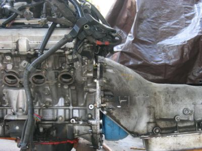

I have a 454 and I think I need a diagram for the interor drivers side of block with any hole that goes to the oil shown; it arterialy bleeds oil in a spray about the diamiter of ones pinkey, leading me to beleve I have lost a plug for a sensor. I can't see the area due to the motor being in the car so if you can a diagram and prognosis check would be helpful.[img:980efc423b]http://www.2carpros.com/forum/automotive_pictures/329114_b2de_1_1.jpg[/img:980efc423b]

Oil pressure switch on that side of block. Try using inspection mirror to see. You runnig a mechanicl oil pressure gague?

It's a first gen 454 so it had mec. one but I beleve it has been changed to ele. I beleve I have lost a plug bolt the size of the sensor. I need to know the size said "bolt-sensor" so I can replace it. a diagram would help with that, unless someone knows the bolt I need. at 10 cents per bolt I'd be OK a few answers. Help.

1/4 in. pipe thread

what is the name of the missing part under the torque converter in the attached pic and does it hold in trans fluid? (not my car just a good pic of the part)

A flywheel cover

napa.com has never heard of a flywheel cover. is there another name? also does it retain trans fluid?

Dealer or bone yard part. No fluid just keeps debris from torque convertor and front oil seal
