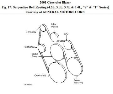

I own a 2001 Chevrolet Blazer 4.3L Vortec V-6 with 52323 miles and the diagram is missing showing route and components for changing the belt. Is the tensioner below the alternator or up top? I've tried loosening both with no release of tension. What am I doing wrong? Do you have a diagram for my engine type showing the components involved with the belt?

Hello !!
Here you have the belt route:
https://www.2carpros.com/forum/automotive_pictures/576_Chevy_Blazer_43_1.jpg
