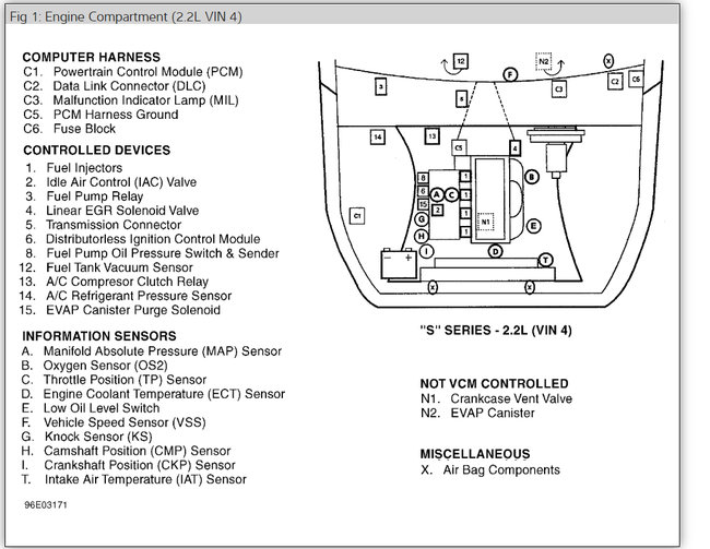

Feb 9, 2007 at 7:51 AM
IUREIS
Finally found a code checker for the S10! The code checker (Actron CP 9001) displays Code #22. The description given in the manual was......Throttle position sensor (TPS) signal voltage is low during engine idle OR Fuel cutoff relay circuit is open or shorted to ground.
Does this make any sense for the shudder problem? And how does that connect with the hard shift problem when the Check Engine light comes on? Thanks again.

The throttle position sensor is like your throttle valve operated by vacuum with the old type tranny. The VSS vehicle speed sensor is the governor

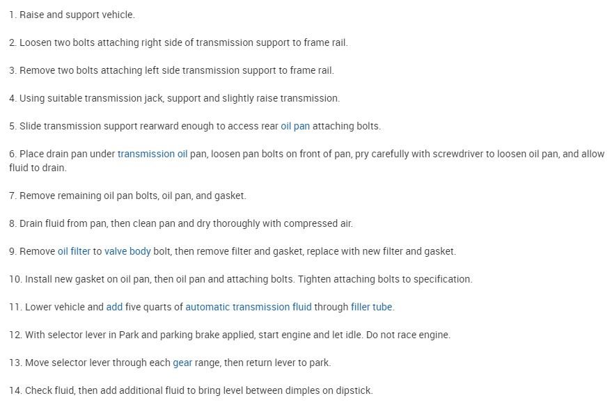

Good morning,
Were there any codes set in the modules? If so, do you remember it?
When was the last time you had the transmission oil/filter changed?

Got it.
Can you check for any codes?
I would start by changing the oil/filter in the transmission.

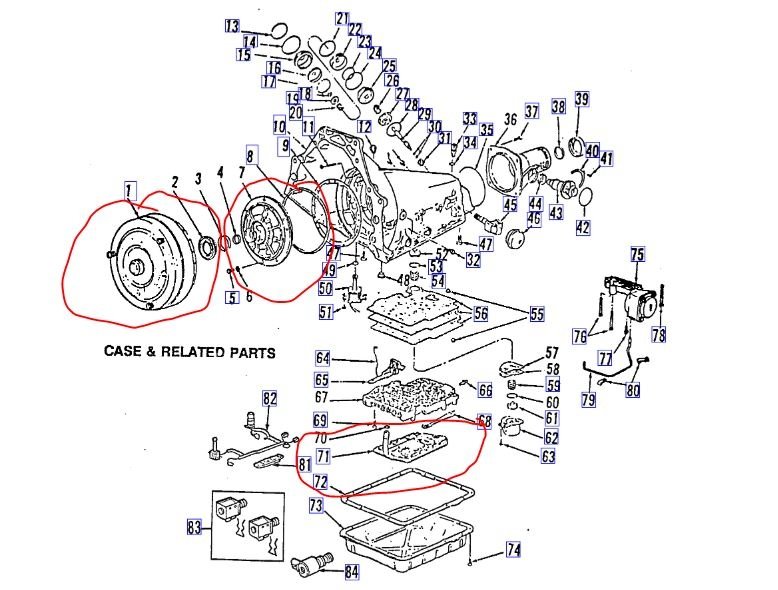

ITSCHAGIRL
tranny trouble i washed my chevy blazer it locked into 4 low.next day it came out of 4 low .i changed the filter now 3 gear revs ,and drive the rpm are at 4 grand if you kick it it will rev then go into drive
Apr 9, 2021 at 12:11 PM (Merged)
  • 110,244 POSTS
Check fluid level to make sure it is full and clean. The washing issue has me confused. Check wiring to the transfer case to make sure every thing is tight and clean. Next, check to make sure nothing was loostened at the TCM. You may have not installed the filter correctly and it's leaking air or it's low on fluid. you'll have to recheck what you have done.

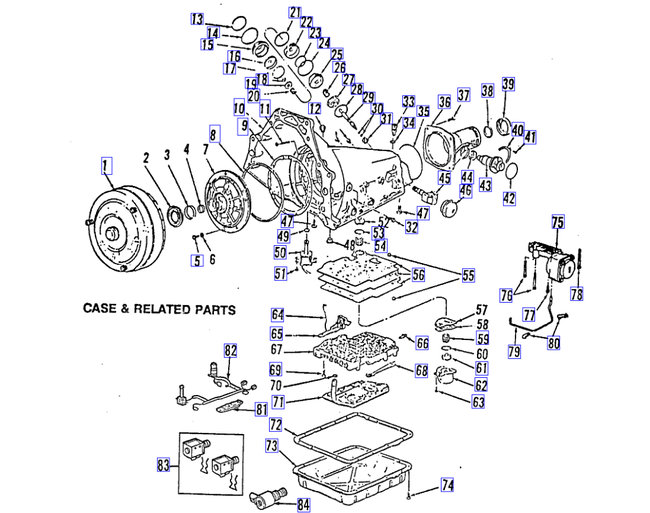

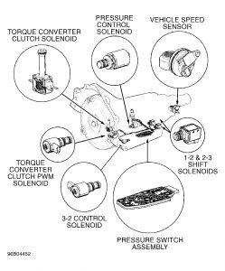

KATLINUHL5727
ABS light came on speedometer quit working and will not shift into third or fourth gear. Showed no signs of transmission failure.
Apr 9, 2021 at 12:12 PM (Merged)
  • 55,423 POSTS
It sounds like the vehicle speed sensor (output shaft speed sensor) has gone out. Here is its location so you can replace it. F and #43 in the diagrams.
Check out the diagrams (below). Please let us know what you find.

BRYANK36
it was the vss thank you.

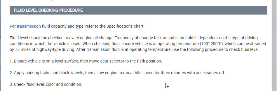

We need to start with the basics. Let's inspect the fluid level and condition. If the fluid is dirty we may need to start with changing it but that is also a sign that the damage is already done and it won't fix it.
So if the fluid is dirty then that is normally caused by a clutch slipping and it burns the fluid which causes more damage and eventually you lose forward gears first and then reverse in most cases.
Below is the process to check the fluid.
Then we need to check for codes.
Let's start with this and go from there. Thanks
