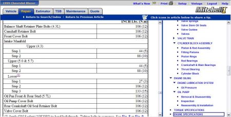

I need the intake manifold torque specs and pattern for a 1999 Chevy Blazer 160000 mi. 4.3l V-6.

Start at the center and work your way outwards in a cross pattern
https://images.2carpros.com/forum/automotive_pictures/12900_1999_blazer_intake_torques_seq_1.jpg
