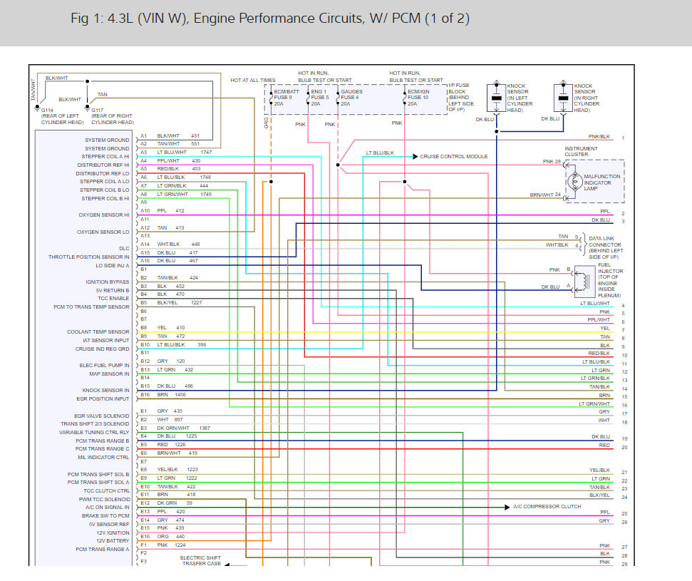

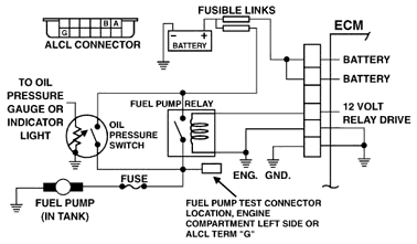

I have '95 chevy blazer with4.3 and 189000 miles. The car has a check engine light on. It's been on for a while. The problem I am having now is the car shuts off on me. It usually happens when I am going over 50. I changed the fuel pump two months back. The mechanic says it is either the fuel pump or the wires t0 the pump. I think it might be the wires. If so, how much of the wires do I have to replace? Any info would be helpful. I cannot make a donation at this time, but will make one in the weeks to come. Thanks, Mike

I doubt it is the wires, first make sure of the actual pump pressure. If it is too low then maybe the pump they used was substandard and isn't putting out enough pressure.
If pump needs replaced then use a AC brand pump and take a close look at the wires to make sure they are in good condition.
I had one blazer where the wire on the inside of the tank got brittle and broke and I changed 2 pumps before I found the problem.

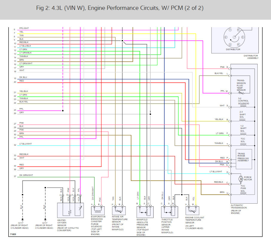

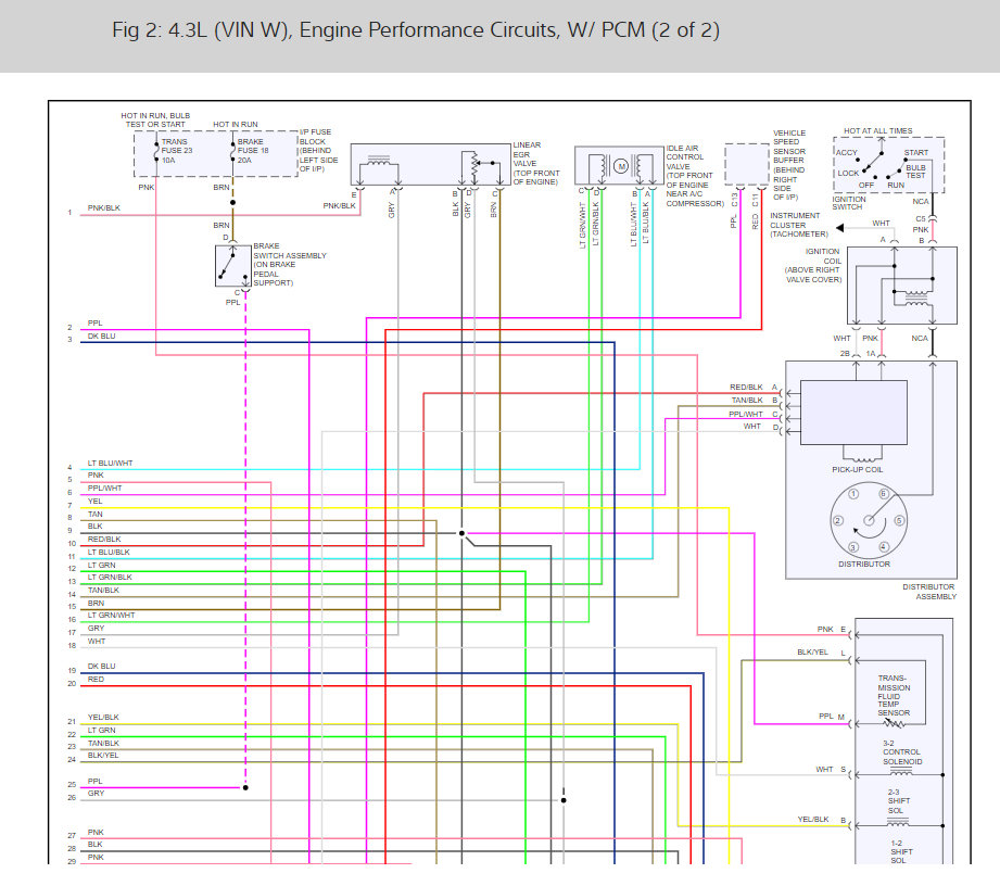

As a side note, I now cut a hole in the floor of my own blazers (I have 2) to access the pump without dropping the tank, much easier and faster and you can cover the hole with a thin metal plate and put the carpet back mover it and you can't even tell it was done. Here are the engine wiring diagrams which include the fuel pump. Check out the diagrams (Below). Please let us know if you need anything else to get the problem fixed

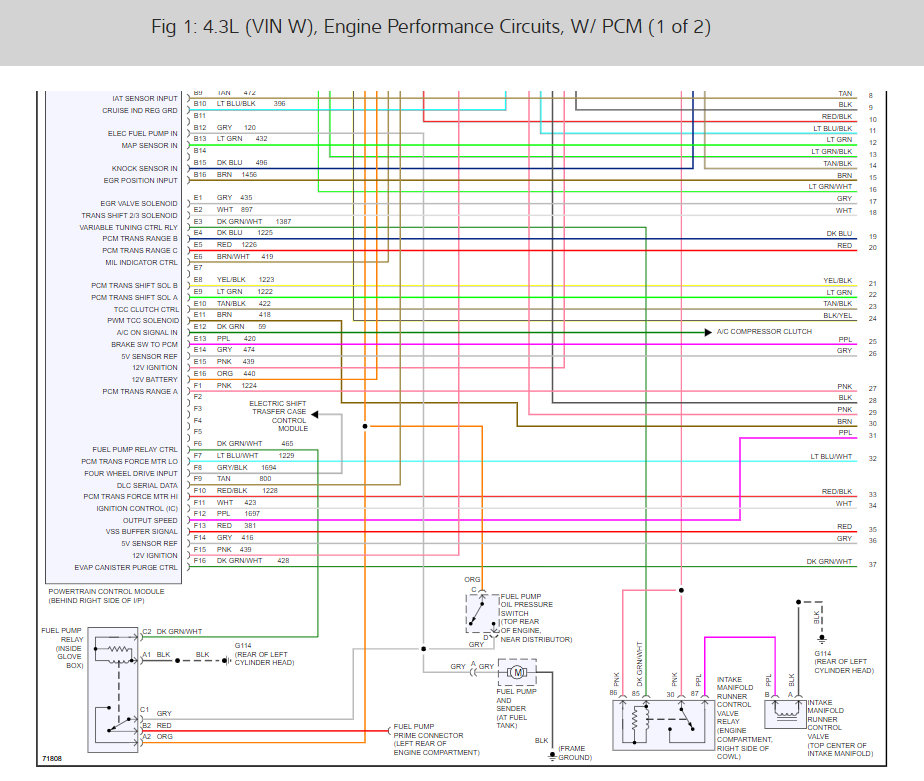

Get the check engine light OBD code/s read and comeback with it.
Could be the fuel pump relay, fuel pump/oil pressure sending unit or a bad pump again. Electrical diagram for the fuel system see below
https://www.2carpros.com/forum/automotive_pictures/12900_oil_sending_unit_and_fuel_pump_circuit_15.gif

I just put a new fuel pump in and I'm not getting any power to the pump I traced the wire all the way to th relay but still nothing even changed the relay still nothing is there a fuse for the punp cause if so I can't find it please help
Saturday, September 7th, 2019 AT 12:47 PM (Merged)
  • 75,992 POSTS
Check the ECM B fuse-Nothing there could be the computer not energizing the fuel pump relay. See diagram below
https://www.2carpros.com/forum/automotive_pictures/12900_oil_sending_unit_and_fuel_pump_circuit_3.gif
