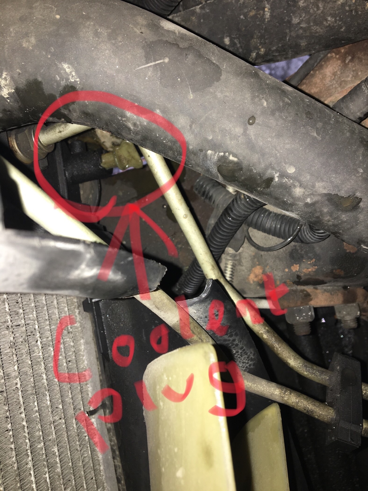

Where is the radiator drain plug located?

The drain should be located on the bottom of the radiator on the drivers side. It looks like a wingnut and turns like one too. However, be careful. Older ones can be brittle and break while trying to open. if you are worried buy a new one before you start, they are cheap and may prevent being stuck with no fluid in radiator when you need to make a trip to buy parts. THis guide can help you service the cooling system witht he drain plug location in the diagrams below.
