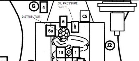

I have a problem with my blazer the fuel pump will keep running when you turn the key off. The only way I can get it to shut off is by unhooking the battery or pulling the ecm batt. Fues could you please tell what to do
Sunday, August 25th, 2019 AT 12:44 PM (Merged)
JDL
  • 16,098 POSTS
Hello, you might check the oil pressure switch. This is the only location I could find.
https://www.2carpros.com/forum/automotive_pictures/170934_blazer_1.jpg
The o/p switch in the fuel pump circuit, may get stuck in the closed position, if it does, the pump will run continue to run.
