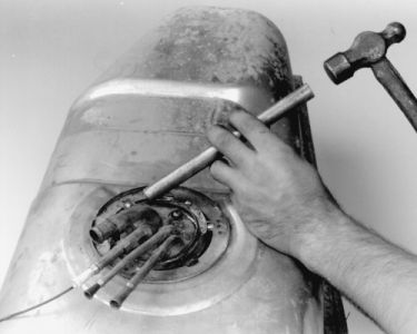

NATE1987
How do I take the Fuel Pump out of its harness?
Aug 25, 2019 at 5:44 AM (Merged)
BLUELIGHTNIN6
  • 16,542 POSTS
Hello Replacement procedures for your vehicle's fuel pump are below.. REMOVAL: Properly relieve the fuel system pressure. Connect the negative battery cable. Using the GM fuel gauge sending unit retaining cam tool No. J-24187, J-36608 (or equivalent) or a brass drift and a hammer, remove the cam locking ring (fuel sending unit) by twisting counterclockwise. With the locking ring released, carefully lift the sending unit from the fuel tank. Remove the fuel pump from the fuel sending unit, by performing the following procedures: Pull the fuel pump up into the mounting tube, while pulling outward (away) from the bottom support. When removing the fuel pump from the sending unit, be careful not to damage the rubber insulator and the strainer. When the pump assembly is clear of the bottom support, pull it out of the rubber connector. (((A brass drift and a hammer can be used to loosen the fuel pump locking cam))
https://images.2carpros.com/forum/automotive_pictures/261618_0900c152802502f4_1.jpg
INSTALLATION: Inspect the fuel pump hose and bottom sound insulator for signs of deterioration, then replace, as necessary. Push the fuel pump onto the sending tube. Using a new sending unit-to-fuel tank O-ring, carefully lower the sending unit/fuel pump assembly into the fuel tank. When installing the sending unit, be careful not to fold or twist the fuel strainer or it may restrict the fuel flow. Secure the sending unit by turning or driving the lockring clockwise and into position under the tabs. Install the fuel tank assembly to the vehicle. Connect the negative battery cable and check for proper pump operation. Thanks for using 2CarPros.com!

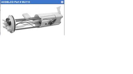

JPSVP
what fuel pump do i need for a 1999 chevy blazer 4wd 4 door?
INTERNETMECHANIC
  • 700 POSTS
I found this in online partsbook, about 318 bucks. You can get cheaper fuel pumps.
https://images.2carpros.com/forum/automotive_pictures/512072_acdelco_fuel_pump_1.jpg

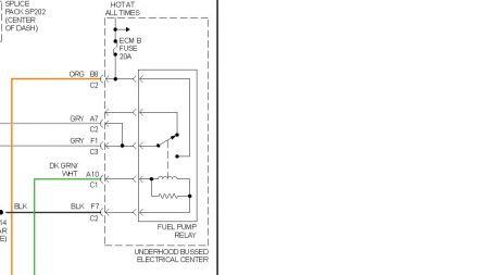

I started my truck the other morning with my command start, I went out, it was running, went back in and it had stopped running. Wasn't sure if it was just out of time. My truck would not start after this. I have a feeling it may be the fuel pump but how would I check for that? Would like to eliminate the cheapest options first. I got my filter undone enough to loose some gas into a container, gas looks good. Please help!
  • 75,988 POSTS
When you turn key to On position-do you hear the fuel pump come on for a few secs? If not Check the 20 amp fuse see below if okay look for power at the gray wire at the fuel pump connector You need to check fuel pressure with a gauge-
https://images.2carpros.com/forum/automotive_pictures/12900_fuse_20_amp_99_1.jpg

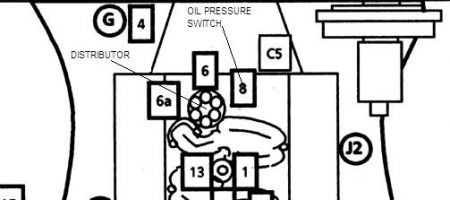

M.ERICKSON77
i have a problem with my blazer the fuel pump will keep running when you turn the key off. the only way i can get it to shut off is by unhooking the battery or pulling the ecm batt. fues could you please tell what to do
JDL
  • 16,098 POSTS
Hello, you might check the oil pressure switch. This is the only location I could find.
https://images.2carpros.com/forum/automotive_pictures/170934_blazer_1.jpg
The o/p switch in the fuel pump circuit, may get stuck in the closed position, if it does, the pump will run continue to run.
