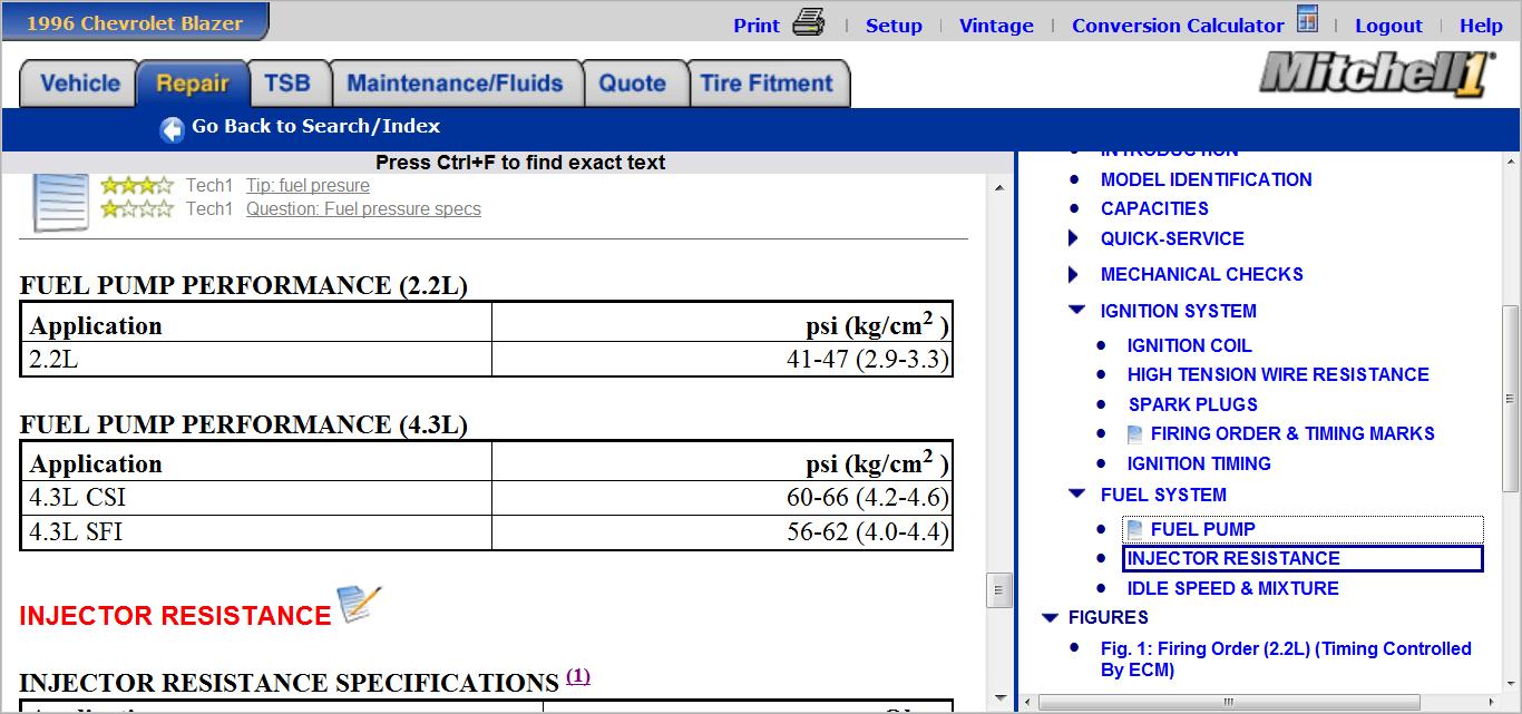

Could be you can rent a fuel pressure gauge from auto zone and see if the pressure is bleeding down. Hook up the gauge start it up and then turn off the engine and watch the gauge and see if the pressure bleeds down if so to what pressure it bleeds down too?Monitor the pressure for 5 mins for dropping.

  • 75,992 POSTS
Fuel pressure specs below:
Thursday, August 22nd, 2019 AT 6:32 PM (Merged)

You need a fuel pressure gage. If the pressure is low, the problem is usually on the supply side, pump, line, fuel filter, the pressure regulator may go either way.
According to the parts book, you do have the spider system.
