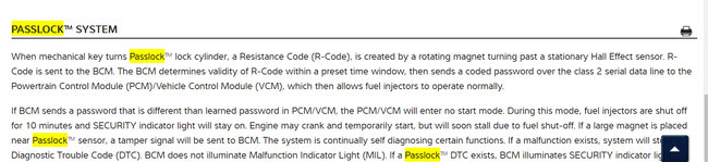

How do I reset my car alarm system I have tried turning the key two times to the locked position and then two times to the unlocked position and it's still engaged

It should disarm when you unlock the drivers door.If not try the passenger door.If neither one of those works, you may need to have a shop scan the BCM to see where the lack of communication is happening. I take it this is a factory alarm and not an aftermarket

No flashing lights but the security light use to blink, but now it is on steady. The car was turning over but wouldn't start and now it won't even turn over. My wife has the original key but I have a duplicate key

May want to try the other key, also follow this procedure
1- Turn key to RUN position, try to start and let key return to ON position
2-After approx. 10 minutes the security light should turn off
3-Turn ignition to OFF position and wait 5 seconds
4-Repeat steps 1-4 two more times for a total of 3 cycles equaling 30 minutes
5- Start engine

We have replaced the computer in our blazer, do we need to reset the security system now? If so how do I do that. Is it possible to remove the security system. We are thinking the security system will not let the injectors work. Thanks
Tuesday, January 8th, 2019 AT 10:40 AM (Merged)
  • 109,913 POSTS
It needs to be reprogramed to recognize the system. Take it to a dealer that has the proper equipment.

I was replacing my headlight bulbs, so I had to disconnect the battery to get to the right side bulbs. Well, when I connected the battery back, the car wouln't crank. Turn the ignition. And nothing! So, how do I reset alarm, or better yet, how can I bypass it? Please help. Thanks.

Are you sure you have a good connection? Is the security light blinking? If it is try this. Turn the key off, turn the key on and crank the starter for a second and leave the key on. Watch for the light to blink. When it stops blinking, turn the key off for about 10 seconds and see if it will restart. Let me know what happends, we will see what else we can do for ya.

I bought the vehicle listed above that had the key cylinder pulled out. I have a 1997 with a bad engine. I took the key cylinder from 1997 in 1996 and after about two times of cranking it the fuel pump had stopped working. I diagnosed everything to the best of my knowledge and finally I decided the security had to of shut the car down So iBook said steering wheel off and swapped everything in column related to security. Key cylinder, wiring harness, switch, etc. The only difference was 1997 shifter in floor were as 1996 shifter is on column. I am assuming neutral safety on is under the dash instead of on column so I spliced the wire. After reassembling still nothing. Oh, I was going to swap brain as well which is where I am in the swap and the numbers are totally different. Can I swap? Should I swap? Where to now? I am sure I have missed something.
Wanted to add I have the title for this car. It is not compromised is any way. The differences of opinions on what can be done is varied. I have made all the changeover from 1997 to 1996. The car is not valued enough to take to a mechanic or dealership so if this can be done if someone knows I would very much appreciate the help. If not then a reasonable explanation would also be appreciated. Thank you.

Today's cars when ignitions are broken and replaced with new or used parts the security system is VIN number matched so when the PCM is activated to start it will not, because the parts you replaced do not match the VIN number. A mechanic can do this with his scanner. So if the car is not worth $100.00 or so if it still ran well and got you where you were going then it should be done.
You might want to put it back together and fix the splice take to a mechanic so he can program it correctly.
