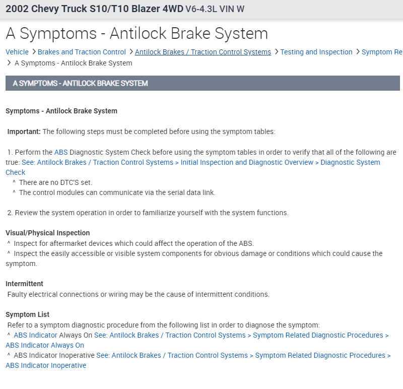

abs light and brake light turn on at the same time?
May 15, 2008 at 6:05 AM
SQM
  • 6,383 POSTS

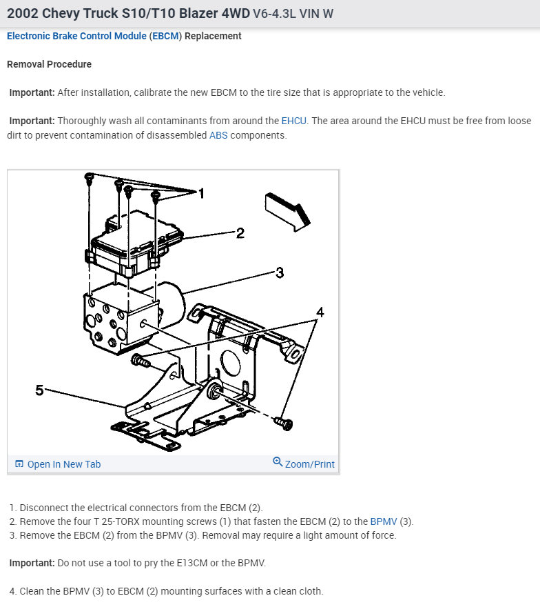

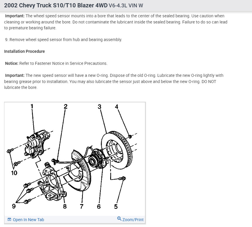

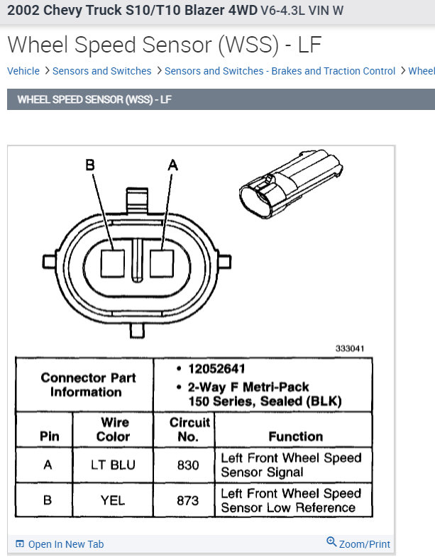

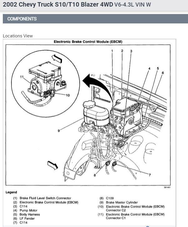

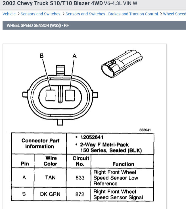

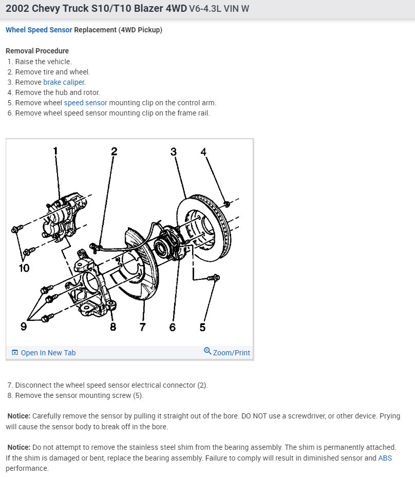

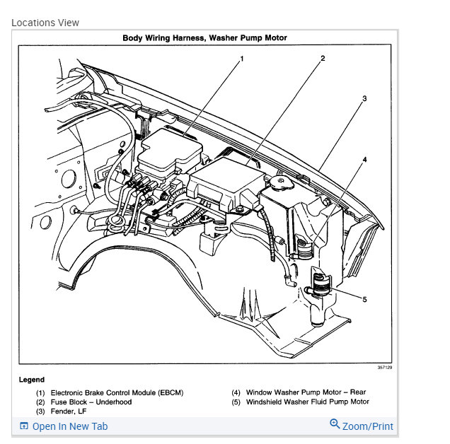

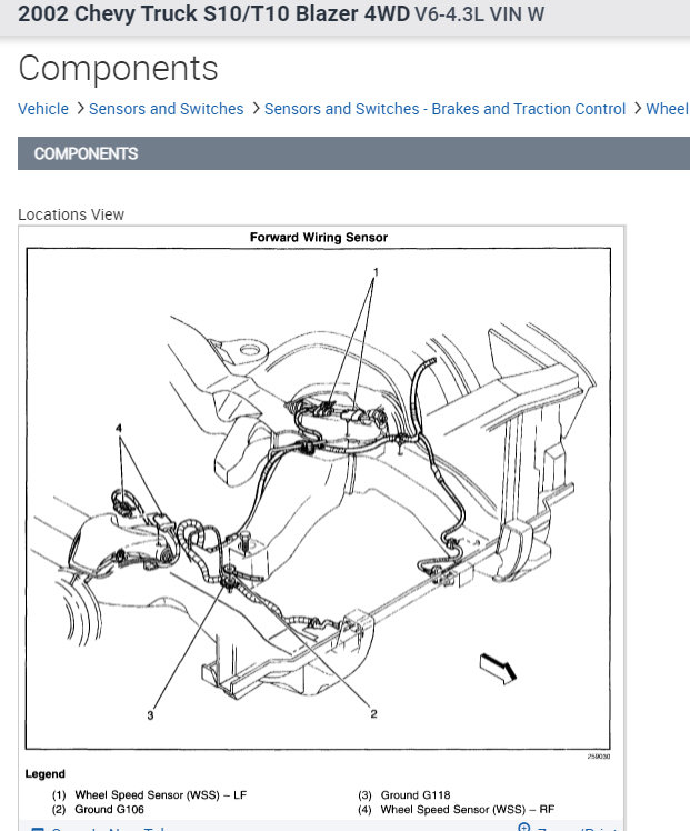

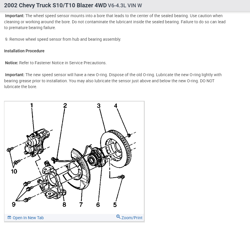

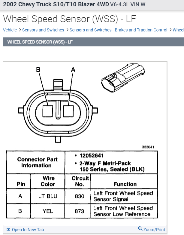

The ABS light gets illuminated when the on-board diagnostic system detects error within the ABS components. It could be a wheel sensor to a faulty module.
The brake light and the ABS light could be related to the same problem.
Best course of action would be to get vehicle scanned for ABS code(s). As it can help with the diagnostics.
Here is a helpful video:
https://youtu.be/rTtAnsOlZU4
Take a look at this guide, it covers the typical ABS issues and fixes:
https://www.2carpros.com/articles/abs-warning-light-on-easy-repair-guide

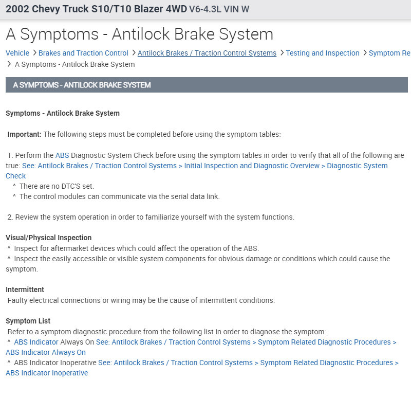

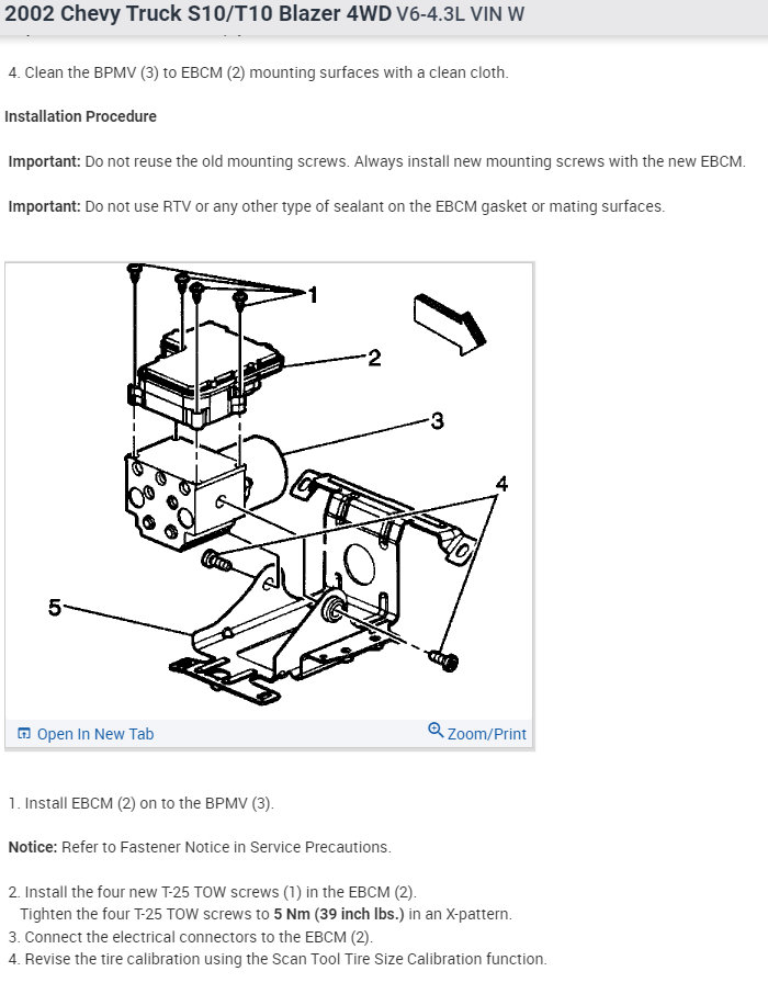

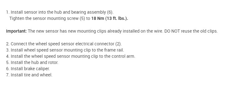

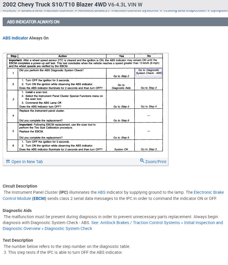

I have attached the ABS light troubleshooting guide below. Also included the ABS components.
