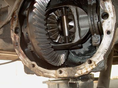

Differential repair or replacement?
2000 CHEVROLET BLAZER
168,000 MILES • 6 CYL • 4WD • AUTOMATIC
DENNIS RICHARDS
The mechanic says that they will have to repair my back differential. The car is not driveable at this time due to the LOUD crunching and popping sounds that happen at slow speeds. The quote was $1600.00 for a repair using a rebuilt differential and $2200.00 if they rebuild mine. If they rebuild it I get a year warranty. The car has 168,000 miles on it and it is now nickle and diming me to death with repairs. Is this cost pretty typical? What do you suggest.
Any suggestions would be helpful.
Dennis
Aug 4, 2009 at 7:42 AM
  • 75,992 POSTS
The quote was $1600.00 for a repair using a rebuilt differential and $2200.00 if they rebuild mine. If they rebuild it I get a year warranty. It only takes 3.5 hrs to remove and replace it not including this main part of the differential assy they gonna deal with see below and it only cost $350.00 Its a bad deal if it was me I'll make an about face and run like a speeding bullet and never ever see this guy again. Its your decision sorry this is all I got
https://images.2carpros.com/forum/automotive_pictures/12900_Powertrax_1.jpg
Aug 4, 2009 at 9:33 AM
PROFSLIME
Just found out that pinion gear is missing a tooth and spiders have some damage to gears. Ring gear looks good. What is the most cost effective way of getting repairs made? Shop that I went to can't make repairs, but told me best course of action would be to replace whole rear with used one, which they can do. Can vehicle be safely driven as is? Only symptom is feeling like you're driving on a washboard when car creeps forward in drive at idle. Otherwise no other symptoms at higher speed. Should I consider going to a transmission shop for repairs? Thanks in advance for your help.

First of all, if the pinion gear is missing a tooth then the ring gear is damaged and/or must be replaced. Ring and pinion gears are a set - you CANNOT interchange them..Even if the ring gear was ok (which I doubt) it must be changed...Damage to both pinion and spider gears indicates that pieces of debris were floating around in the rear..It will be more cost effective to replace the entire unit as compaired to repairing it..The only question is what is your price range -- a junk yard unit will have some miles on it -- call for prices. A new unit will run around $600.00- with zero miles on it and a warranty..
It is not smart or safe to drive this vehicle with a damaged pinion gear and spider gears...The rear WILL eventually sieze and explode. This could cause transmission - transfer case - and engine damage...

Thanks for your quick response! It has been most informative. Shop that did work guesstimated cost of junkyard unit to be in $500.00 range. Sounds like I need to be looking for different shop. They knew of damage but failed to tell me about it. They had done other work to vehicle, new brake lines, two new tires and new diff cover because old one rusted thru and was leaking. I returned a week later when my wife who drives vehicle daily told me about symptoms. A mechanic in shop told me about what they had previously found, but nothing was documented and no one told me previously. They also told me it would be okay to drive car until they could work up estimate. Where can I find new rear for $600 range. Would it be a complete unit or parts to rebuild ? Also I am new to the forum and had already contributed upon asking my initial posting. Thank you once again for your help!!!!
May 14, 2021 at 5:25 AM (Merged)
PEAR69
  • 1,482 POSTS
The $600 is just an estimate and is for just the parts required for a new rear (labor will be more)..If you want to purchase the unit yourself you must know what the gear ratio is, what size the differential is, and how many splines there are on the axle. It is most likely an 8.5 inch rear but you should go to the drivetrain specialists web site. There you can see what is involved with identifying what rear you have..You can also purchase everything you need there...You must also decide what type of traction you want - limited slip or posi..If installing a new unit, I suggest going with a Trutrack with the new stock gear ratio ring -n- pinion and a timken bearing installation kit....If you do not know how to install this init I suggest having a professional do it. DTS has instructions, but if you don't know what you are doing you can easily mess it up...Once again, driving this blazer will lead to more damage ..
BTW - be aware when purchasing a new ring -n- pinion gear set..There are different manufacturers. O.E.M. is the quietest gear set and I suggest O.E.M. But if you are planning on going off roading and stuff like that then Richmond - U.S Strange - AAM gears are what you want..Motive Gears are junk...

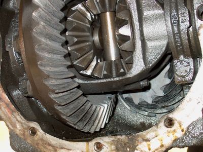

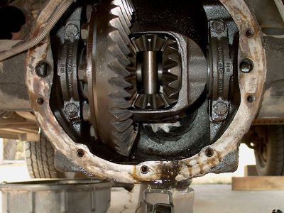

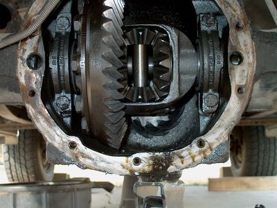

I have a 1988, K5 Blazer, automatic transmission, 4 wheel drive with a 5.7L engine with about 100,000 miles on it. I lost the oil in the rear end and locked up or seized the bearings where the yolk enters the rear end. Possible damage to axle bearings also. I am trying to decide rather to fix what I have, if possible, or find a whole rear end at a salvage yard. I need to know what size rear end came in this vehicle. I have opened it up and all the gears are in pretty good shape. I am fairly sure, no positive, that it is the stock rear end for that year. Can you please tell me what size rear end I have in it? Do you think it is worth re-building? My axles turn freely with no growling or noticeable damage. I would replace anyway. I believe my main problem is the bearing where the drive line and yolk enter the rear end. That is froze up solid, or pretty close to solid. I will included a pic I took and maybe that will help determine some of this. Thank you very much in advance. DonH Sterling, CO
https://images.2carpros.com/forum/automotive_pictures/112189_Blazer_rear_end_002_1.jpg
https://images.2carpros.com/forum/automotive_pictures/112189_Blazer_rear_end_001_1.jpg
https://images.2carpros.com/forum/automotive_pictures/112189_Blazer_rear_end_003_1.jpg
https://images.2carpros.com/forum/automotive_pictures/112189_Blazer_rear_end_004_1.jpg
May 14, 2021 at 5:26 AM (Merged)
MERLIN2021
  • 17,250 POSTS
That is called a 10 bolt rear end. Count the teeth on the ring gear and then divide the number of teeth on the small pinion gear that will give you your ratio. Make sure you measure the overall width and check the spring perches.
If the pinion bearing seized and there is a lot of metallic flaking in the case you are better getting a used rear end and installing it.
Cheers

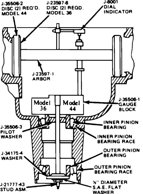

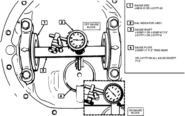

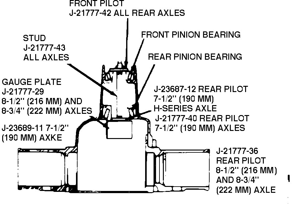

I am installing new gears I the front end of my vehicle and I got the old shim on the new pinion and new bearings. When I tighten the nut the pinion is too tight to turn and it's not over tightened I barely wrenched it on.and if I back off a bit and turn the pinion then I can hear the (new) crush sleeve has not been crushed it's moving in there. I'm thinking maybe have to go with smaller or no shim on pinion?
  • 110,244 POSTS
Welcome to 2CarPros.
I need to know which differential you have. There are several that could have been used. Here is the list of possible differentials.
Adjustments
Borg Warner
Dana/Spicer
Timken/Rockwell - 12 Inch Ring Gear
K5_BLAZER
It's a GM 10 bolt 8.5 ring gear.
  • 110,244 POSTS
Welcome back:
I believe this is what you need. Take a look through it and let me know. The attached pictures correlate with the directions.
__________________________________________
Adjustment
1. Install pinion bearing races in housing using a suitable driver.
2. Lubricate pinion bearings and install bearings in races.
3. Mount depth gauging jig in housing, Fig. 8, noting the following:
a. Assemble gauge plate onto preload stud.
b. Hold pinion bearings in position, insert stud through rear bearing and pilot and front bearing and pilot, then install retaining nut and tighten nut until snug.
c. Rotate tool to ensure bearings are properly seated.
d. Hold preload stud and tighten nut until 20 inch lbs. of torque, which is required to rotate stud. To prevent damage to bearing, tighten nut in small increments, checking rotating torque after each adjustment.
e. Mount side bearing discs on arbor, using step for disc that corresponds to base of housing.
f. Mount arbor and plunger assembly in housing, ensuring side bearing discs are properly seated, install bearing caps and tighten cap bolts to prevent bearing discs from moving, Fig. 9.
4. Mount dial indicator on arbor stud with indicator contact button bearing against top of arbor plunger.
5. Preload indicator 3/4 revolution and secure to arbor mounting stud in this position.
6. Place arbor plunger on gauge plate, rotating plate as needed so that plunger rests directly on button corresponding to ring gear size.
7. Slowly rock plunger rod back and forth across button while observing dial indicator.
8. At point on button where indicator registers greatest deflection, zero dial indicator. Perform steps 7 and 8 several times to ensure correct setting.
9. Once verified zero reading is obtained, swing plunger aside until it is clear of gauge plate button and record dial indicator reading. Indicator will now read required pinion depth shim thickness for a ``nominal'' pinion.
10. Inspect rear face of drive pinion to be installed for a pinion code number. This number indicates in thousandths of an inch necessary modification of pinion shim thickness obtained in step 9.
11. Select pinion depth adjusting shim as follows:
a. If pinion is stamped with a plus (+) number, add that number of thousandths to dimension obtained in step 9.
b. If pinion is stamped with a minus ( - ) number, subtract that many thousandths from dimension obtained in step 9.
c. If pinion is not stamped with plus or minus number, dimension obtained in step 9 is correct shim thickness.
12. Remove gauging tools and pinion bearings from housing, noting installation position of bearings.
Installation
1. Install selected shim onto pinion shaft, lubricate rear pinion bearing with specified axle lubricant, then press rear bearing onto pinion using suitable spacers.
2. Install new collapsible spacer onto pinion shaft, then insert pinion assembly into housing.
3. Lubricate front pinion bearing, install bearing into housing and tap bearing over pinion shaft with a drift while assistant holds pinion in place. Old pinion nut and a large washer can be used to seat front bearing on pinion, but care must be taken not to collapse spacer if this method is used.
4. Install new pinion seal in housing, coat seal lips with grease, then mount driveshaft yoke on pinion shaft, lightly tapping yoke until several pinion shaft threads protrude from yoke.
5. Coat rear of pinion washer with suitable sealer, then install washer and new pinion nut.
6. Hold driveshaft yoke with suitable tool, then alternately tighten pinion nut and rotate pinion until endplay is reduced to zero.
7. When endplay is reduced to zero, check pinion bearing preload using a torque wrench.
8. Continue tightening pinion nut in small increments until 35-40 inch lbs. of bearing preload is obtained with new bearings or 20-25 inch lbs. of bearing preload is obtained with used bearings, rotating pinion and checking preload after each adjustment. Exceeding preload specification will compress collapsible spacer too far, requiring replacement of spacer. If preload specification is exceeded, spacer must be replaced and adjustment procedure must be repeated. Do not loosen pinion nut to reduce preload.
