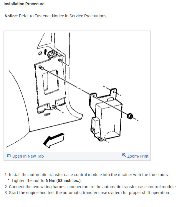

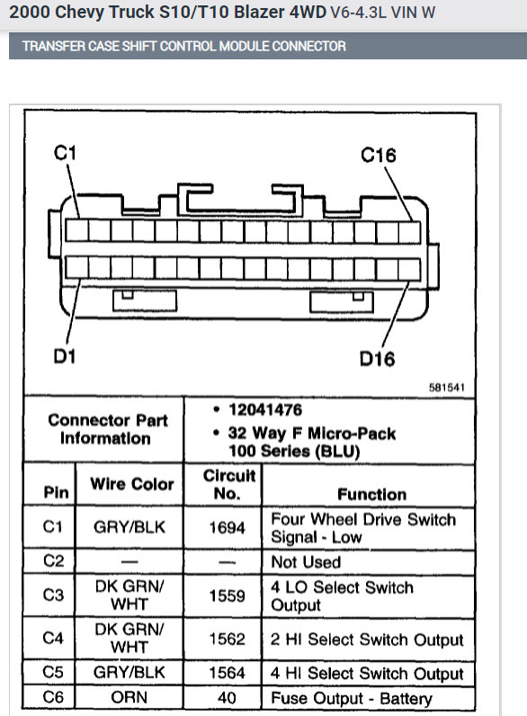

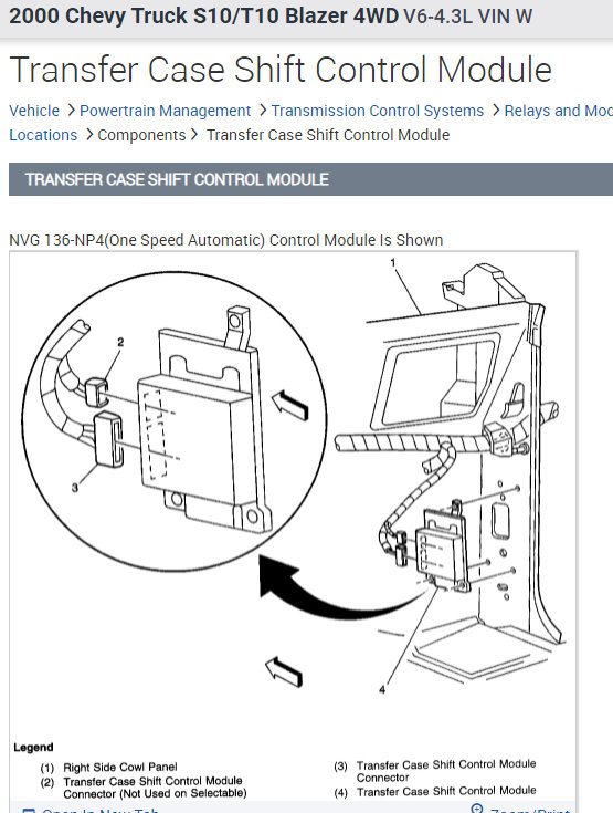

You might have an issue with the transfer case control module.
As after you push the button the module sends signal to the transfer case to change the mode.

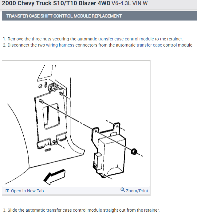

The module is located behind the passenger side kick panel (see diagram).
Replacing the module requires taking off the mounting bolt and taking off the harness.
