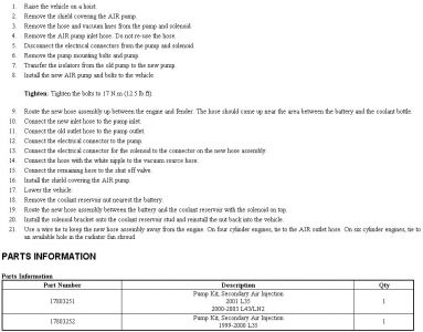

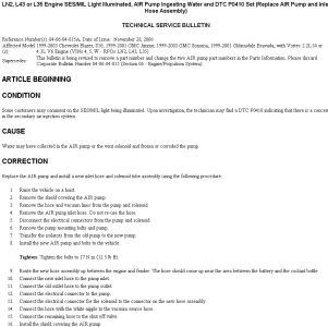

Bear with me a minute. there is a kit that has been added to this truck to prevent further failure of this.
I will update.
https://www.2carpros.com/forum/automotive_pictures/30961_tsb1_1.jpg
https://www.2carpros.com/forum/automotive_pictures/30961_tsb2_1.jpg

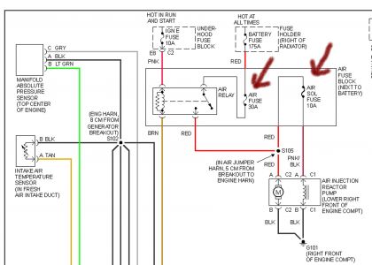

To test this, you'll need a scanner that is capable of commanding the pump on and montor other reading. Are there any other codes at all?
Check these fuses:
https://www.2carpros.com/forum/automotive_pictures/30961_tsbap_1.jpg
