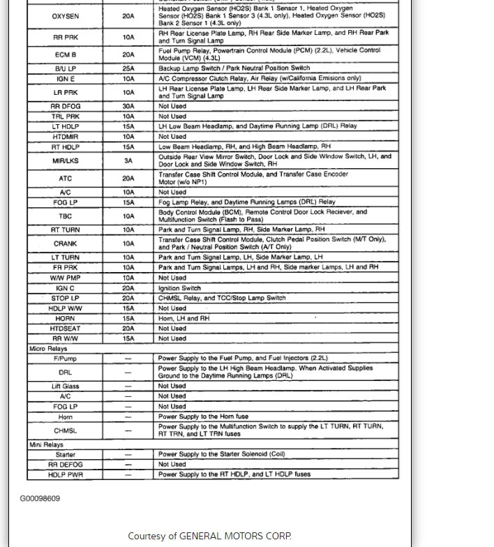

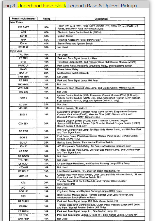

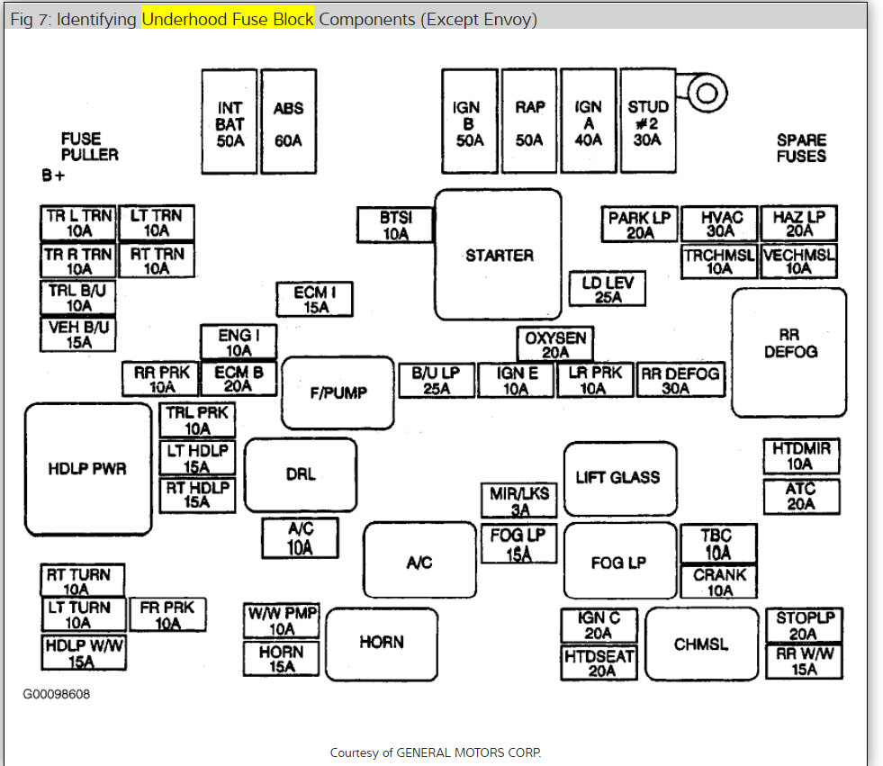

Hi jim109,
here is guide to help you check it with the relay location in the diagrams below.
Check out the diagrams (Below). Please let us know what you find.

JIM109
thank you the relay was bad Im back on the road!

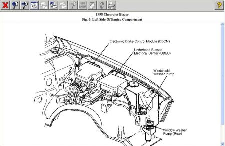

OSCODAPAT
I have replaced my fuel pump but it not whurring when i turn on the key. Where is the fuel pump relay on this model. It not on the pass side firewall nor behind the glove box. On the fuse box is one power relay and that one is good. There seams to be no power to the the pump.
Jan 30, 2021 at 12:31 AM (Merged)
  • 75,992 POSTS
Its inside the underhood bussed electrical
https://images.2carpros.com/forum/automotive_pictures/12900_relay_box_1.jpg
OSCODAPAT
is it under the inside fuse box or just the one on the fuse box
Jan 30, 2021 at 12:32 AM (Merged)
  • 75,992 POSTS
Its inside the bussed electrical center-don't have the info on which is which tried but couldn't come up with it-

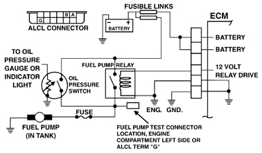

  • 75,992 POSTS
All you got is 2secs to check for power before the fuel pump relay de-energizes then you lose power to the pump. The computer energizes the fuel pump relay. Did you check the fuel pump fuse?
https://images.2carpros.com/forum/automotive_pictures/12900_oil_sending_unit_and_fuel_pump_circuit_55.gif

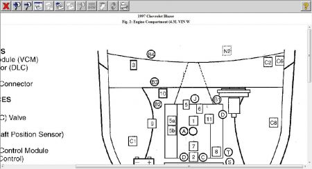

RLPZ75
i drove it just fine yesterday and today it would not start, i cannot hear the fuel pump start like i used to, i replaced the fuel pump relay, it was inside the glove compartment, far left one and it stillo didn't do any good, am i looking at changing the fuel pump?
  • 75,992 POSTS
Before you get to the fuel pump better check the ECM BATT fuse no.9 20amp if okay -direct battery voltage to the fuel pump and see what happens. If it doesn't come on then replace it
RLPZ75
i want to make sure i have the right relays first, the fuse it's ok, there are three relays, are those the right ones? and how do i direct voltage from the battery to the pump
  • 75,992 POSTS
The fuel pump relay is behind the glove box see item no.3 below for location Run a wire from the battery positive post to the gray wire on the fuel pump conector
https://images.2carpros.com/forum/automotive_pictures/12900_fuel_pump_relay_20.jpg
