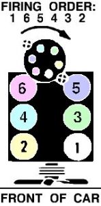

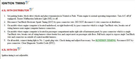

I cannot find the wire on the distributor, to hook up the timing gun.

It hooks to spark plug wire on # 1 cylinder

You just need to hook ir up the the Number 1 cylinder Plug Wire.
