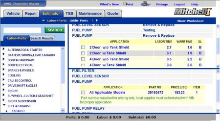

I'm using a new mechanic in a new town. I'm a single woman and always fear I'm getting taken advantage of. Approximately how much should it cost to replace a fuel pump on my 1995 Blazer? The car cranks, but won't turn over until after many many cranks. Thanks!

Labor rate could range $70.00-$130.00 varies with location. See below quotes
https://www.2carpros.com/forum/automotive_pictures/12900_fuel_pump_rr_1.jpg
