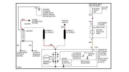

I was replacing my alternator and now that I have put it in, I have a problem. I don't remember where the two wires go. i think they are from the battery (since one is red and the other is black). is there any diagram available for this?
Jul 26, 2008 at 7:54 AM
  • 75,988 POSTS
See below

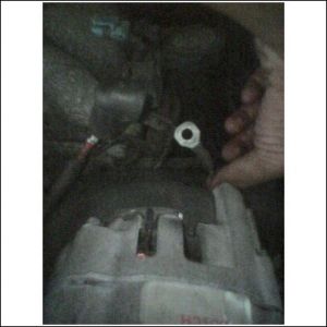

MALEONAR
I really can't see the diagram that good. I just took a picture for you to see what two wires i am talking about
