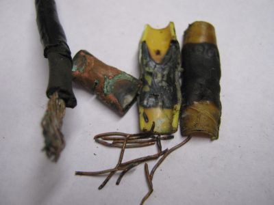

Wanted to give y'all a heads up. Husband was checkin out the wiring again tonight, and was lookin down by the starter, and found a completely fried wired that had been spilced to the starter from the alternator. (pic) Cut it off, and rewired it. Also found ANOTHER wire near the alternator that was broken, and pretty much held together by about 3-4 lines of the wire. Fixed that too. He;s thinking that the broken wire up top was for the actual gauge though. Still need to replace this last alt because it did fry up on saturday. We shall see after we put the next one it how it goes.

Thats ugly, but remeber the wires at the starter solenoid are usually fusible links... circuit protection... replace with new links!

this particular wire comin from the alt to the starter was actually spliced, and the splice is where it was fried. Looks to be something that may have been done possibly when the engine was replaced. It was most likely done by someone who probably thought they knew what they were doing, and that thought they did it right. Assuming the original wire that came off and went to the starter either was damaged or broken when the engine was replaced, so whoever just spliced an extension on it to get it where it needed to go. I appreciate all the information given to me by your site. Will let you know how it goes, and if it is fixed or not.
