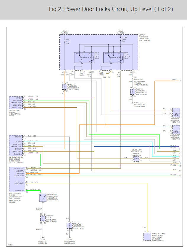

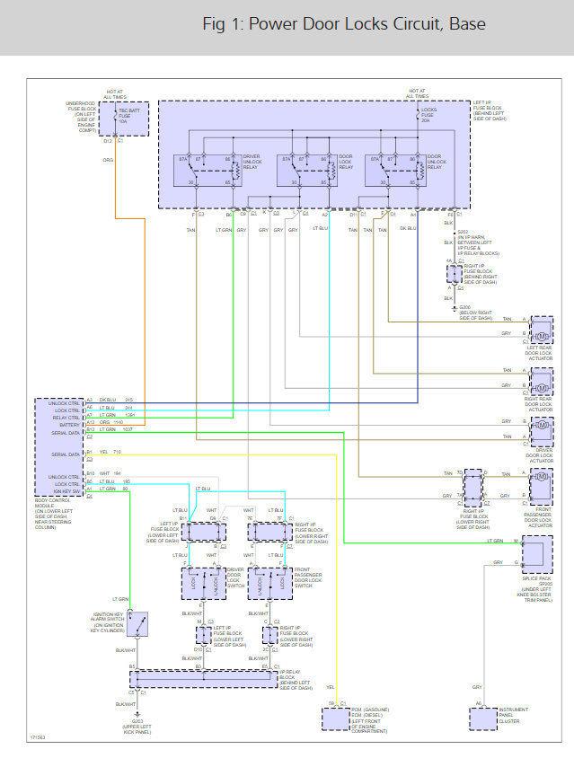

Here is the problem, when you lock the door all four doors will lock. When you unlock the doors only the front two will unlock. I thought maybe the relays so I found them and swapped them out they both had the same part number. The problem changed when you unlock the doors all four will unlock but when you lock them only the front two will lock and you can open the back two door and not set off the alarm system. I think I am chasing a wiring problem need a schematic to help trouble shoot or is there another relay that I don't know about.

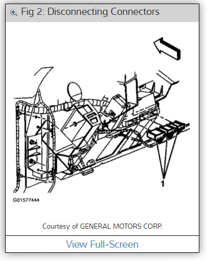

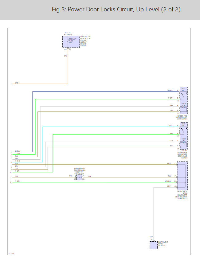

Here are the wiring diagrams for the door locks and a guide to help you see where you are losing power at.
and
https://www.2carpros.com/articles/electric-window-repair
Here are the door lock wiring diagrams, if everything checks out the BCM has gone bad and needs to be replaced.

Thanks for the guides I did some testing and found it was the BCM I got a used one for 150.00 and now everything is working great.
