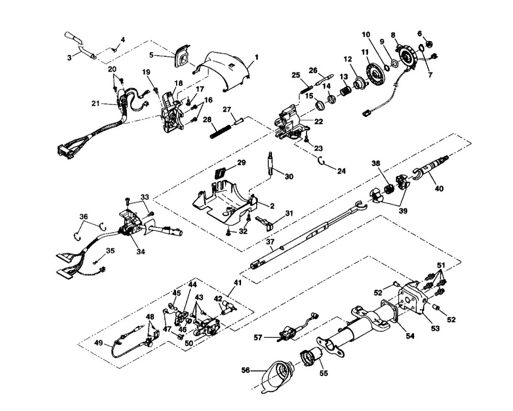

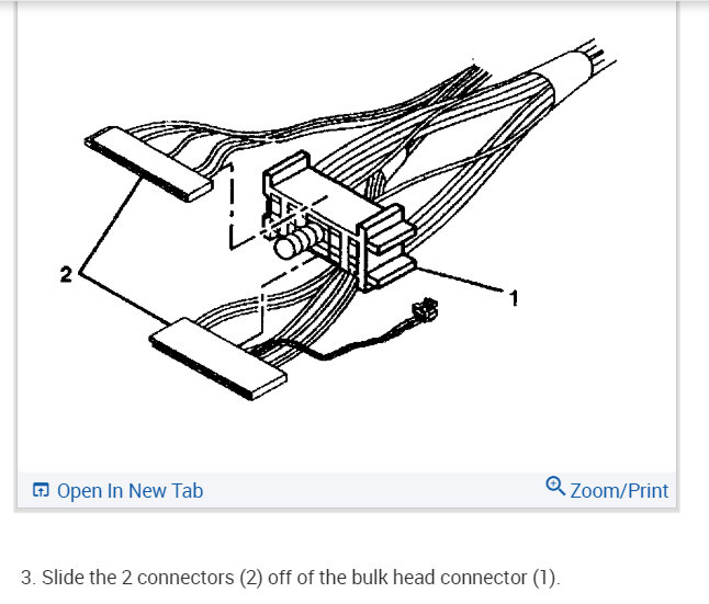

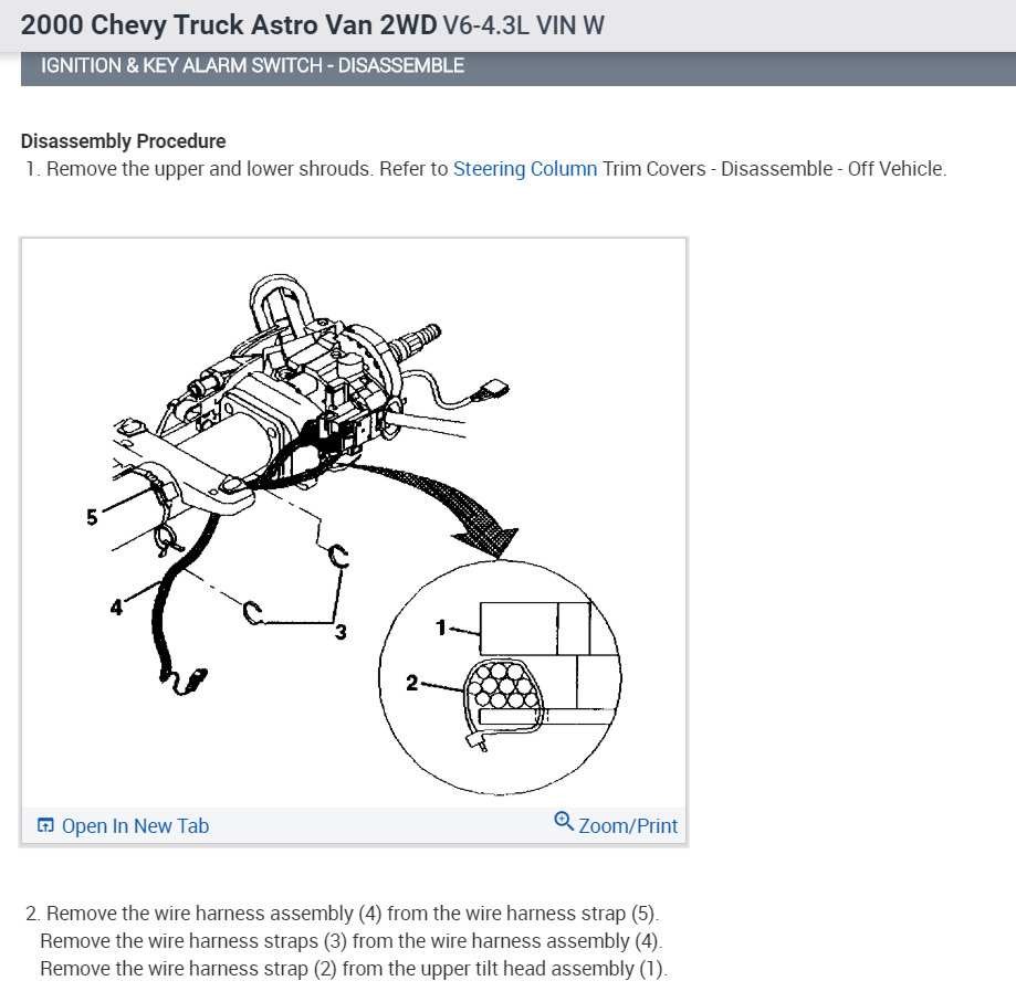

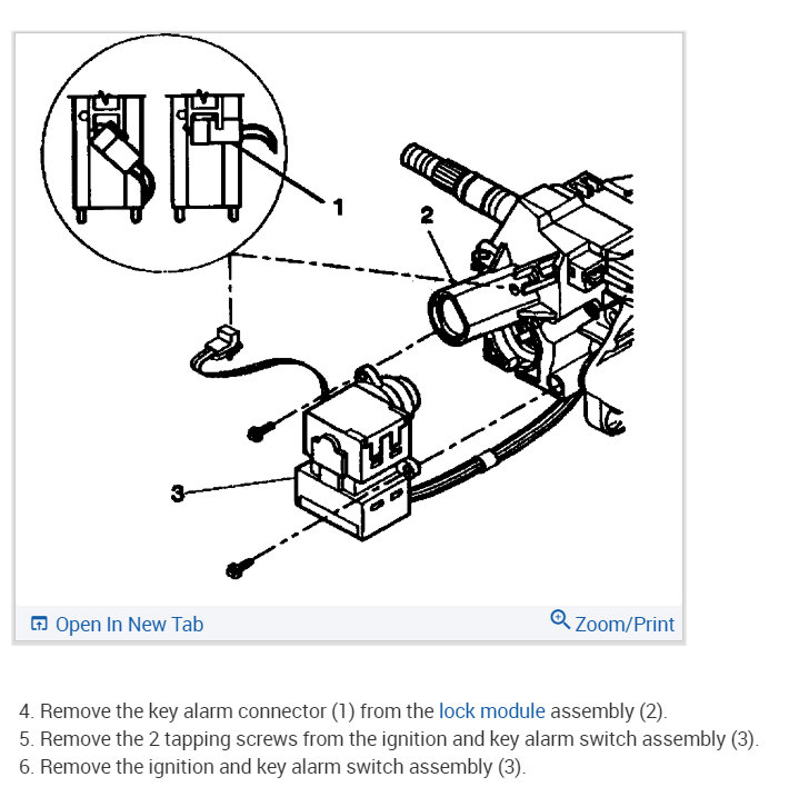

I have seen some strange things come from a bad ignition switch. Go to the fuses for the stereo and heater fan, stuff that only works when key is on. When nothing is working see if there is power to these fuses, if not the switch is most likely the culprit. Here are instruction on how you can change it out in the diagrams below.
