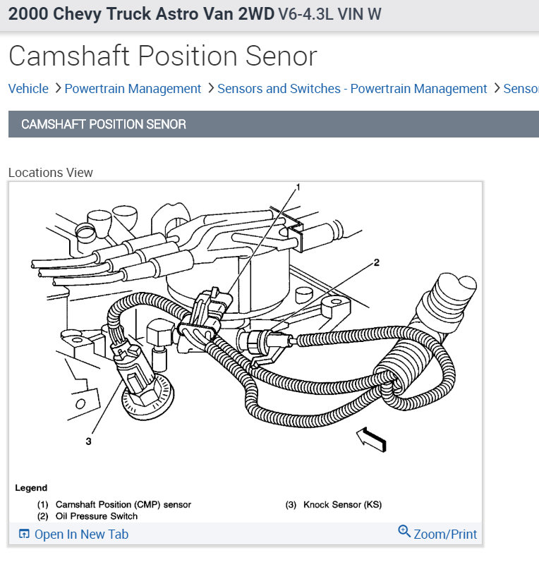

Where is the camshaft position sensor on our van 4.3L?
Dan
Oct 19, 2009 at 2:59 PM
  • 75,992 POSTS

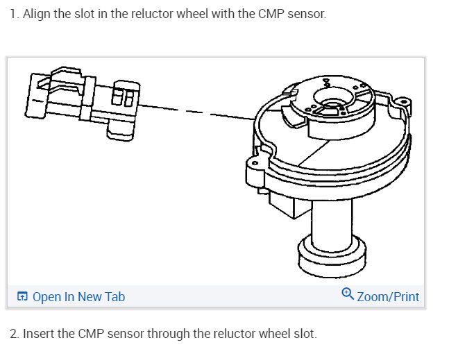

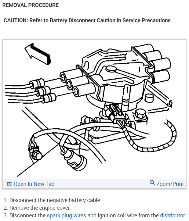

The camshaft position sensor is located inside the distributor here are diagrams below to show the location and how to change it. Check out the diagrams (Below). Please let us know if you need anything else to get the problem fixed.

first thing is to take dist cap off and see if there is any movement in rotor, there should not be then if there is get anew dist as the gear is worn. then a pro will have to set that correlation between the two with his scanner. the cam sensor is in dist. and crank sensor in timing cover.
