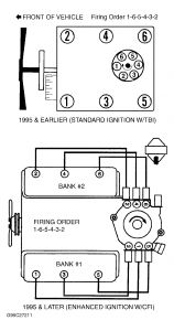

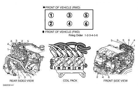

Having trouble in remenbering how the wires go connected on to the plugs, Like what goes with what!

Hi there,
Firing order for all variants see pics.
