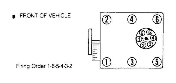

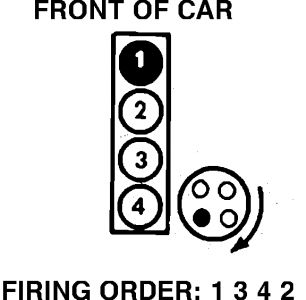

The van is backfiring I was wondering if I have a crossed plug wire.  I replaced the plugs and wires also. Thanks For the help
Jun 20, 2008 at 2:14 PM
  • 55,554 POSTS
Yes, this can be the problem, here I have included some firing order diagrams so you can double check. Please let me know if you need anything else.
https://images.2carpros.com/forum/automotive_pictures/12900_f1_7.jpg
https://images.2carpros.com/forum/automotive_pictures/12900_f2_6.jpg
Best, Ken

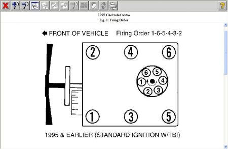

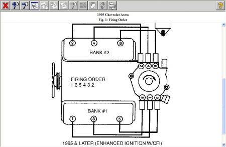

what is the Firing order for 1995 chevy astro 4.3L
Jun 29, 2020 at 4:33 AM (Merged)
SERVICE WRITER
  • 9,123 POSTS
1-6-5-4-3-2

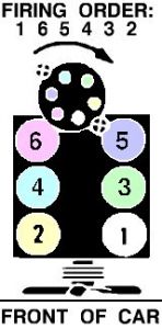

When the plug wires are coming from the distributor cap to the Spark Plugs, Which wire goes to which plug?
  • 110,246 POSTS
Here is a picture of what you need.
https://images.2carpros.com/forum/automotive_pictures/249084_firing_order_4.jpg
Let me know if it helps. Joe

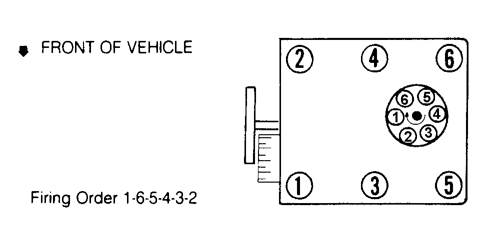

what is the firing order on the distributor cap?
Jun 29, 2020 at 4:34 AM (Merged)
  • 75,988 POSTS
Specifications FIRING ORDER
https://images.2carpros.com/forum/automotive_pictures/12900_fo_139.jpg
