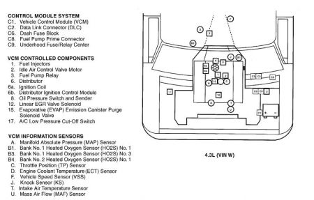

1998 Chevy Astro FUEL PUMP
RACHEL KENDRICK
  • 1998 CHEVROLET ASTRO
1998 Chevy Astro 6 cyl All Wheel Drive Automatic
DOES THIS VAN HAVE A RESET BUTTON FOR FUEL PUMP AND IF SO WHERE?
Saturday, March 14th, 2009 AT 7:45 PM
BLUELIGHTNIN6
  • 16,542 POSTS
No, your vehicle is not equipped with an inertia switch. Only a fuel pump relay is attached to the fuel pump circuit. Is your fuel pump not kicking in? Try inspecting the fuel pump relay located in the underhood fuse/relay center, pictured below..
